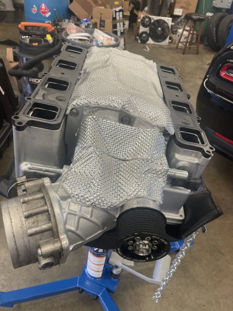

Lfrx7’s are in. Car idles so much better… wonder why…
Out with the old…
griptec makes a solid product
put back on my spacer plates and put a new heat blanket on

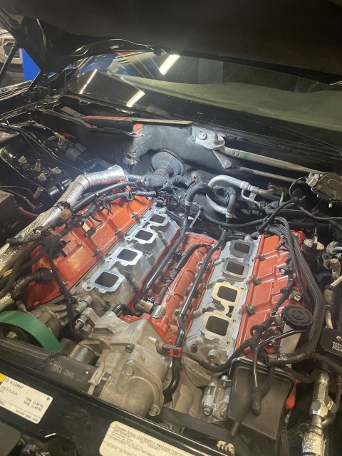

mike found an oring that needed fixing, he recommends lithium grease as I told him I used oil, he says oil can make them expand in a bad way

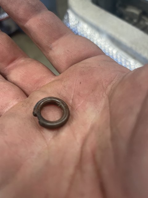

Where’s that oring from?

Oring was from the injectors. We inspected them. Seated in the S/C. Glad we found it. Next test n tune is this week hopefully.

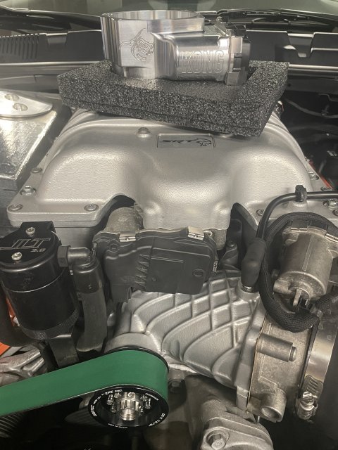

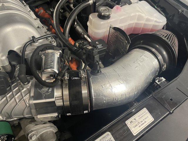

The TB is physically attached. I did a throttle re-learn from VCM scanner. If anyone is running a 108mm throttle body from Kong, can the disclaimer on their site with “No tuning” required be correct or is that for stock applications only?

I have 0 experience with one but a 108 seems fairly big for no tune required. Just my thoughts I could be wrong. I'd think if you tuned for it there would be more gain than not tuning for it.
7,599
19,923
Maybe. It's air flow right? So since these cars are wideband all the time the fueling can likely adjust for the TB. You have 10%+/- of fueling adjustment that won't be any problem, more than that I'd want to adjust it. Won't throw a code until +/- 30% though if memory serves.
If the car doesn't have a freak out at idle then maybe it is plug and play. Personally I'd wanna dial the fueling in though just because.
Historically if the TB was a problem for the tune you'd get some surging and up/down rev all on its own at idle.
Looks awesome Fuman !
I think you would want to fine tune it with all the changes that you made.
One tid bit that I noticed that I think you should insulate the coolant tank next to your air filter. That tank gets perty hot & puts off a lot of heat.

Researching all the tables that will need to change, in other news the 15” conversion is on the way. 15” Forgestar D5 beadlocks are ready to go, now just deciding on the tire. 275/60r15 would be appropriate I think for my power level.

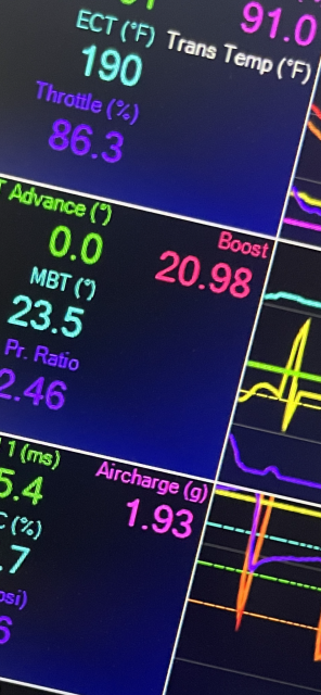

Status update, car idles and drives fine without a tune. Even had a chance to hot wot and it performed as expected. I definitely felt myself almost turtle when it sucked me back into the seat.
Very healthy.
4,385
10,911
20 psi. Come on rookie numbers 😂

Wow, that's moving some air. How did the fuel trims look at cruise with the TB?

Throttle bodies can have similar airflow characteristics and behavior at idle and light loads despite being different sizes. They can also deviate drastically even when they are similar sizes. I cringe every time someone says they have a “custom” hand ported stock tb that needs tuning cause you’re basically dealing with a mystery box that often takes way too much time to dial in for decent drivability characteristics. The behavior just deviates too much from stock to be worth while in my opinion.
The 108’s are the easiest aftermarket tb’s to tune “requiring” no tweaks usually to function like stock. Can’t say the same for other tb’s.

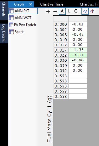

This is on a 10 minute drive to Home Depot, the -3.xx has existed before the throttle body, I just haven't cared enough to get it closer since it's under 5%. I've attached the log.

I do have to say I've been pleasantly surprised that this one is behaving nicely so far, I did do a quick hit at WOT and everything looked fine, track time tomrrow will tell the true tale. If I do need to make adjustments @zhc what channels should I log, right now I'm logging Sonic Air Flow.
7,599
19,923
That looks close to me. I'm curious what gains can be expected from a TB.
Imo TB alone, none, you will create a sharp edge that will create turbulence. I have a port job from Kong to match it.
