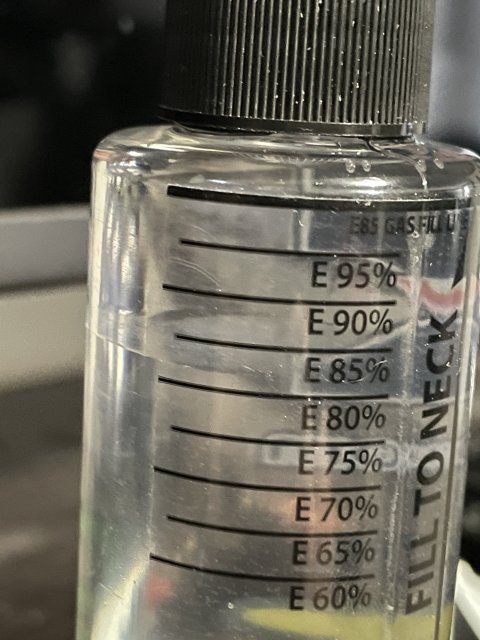

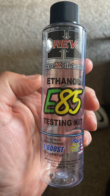

Got about 15 gallons. Testing e82.5?
62,236
217,483
about where mine has been. This week it was 85% though. I have only been using one station that is just down the road from the house
