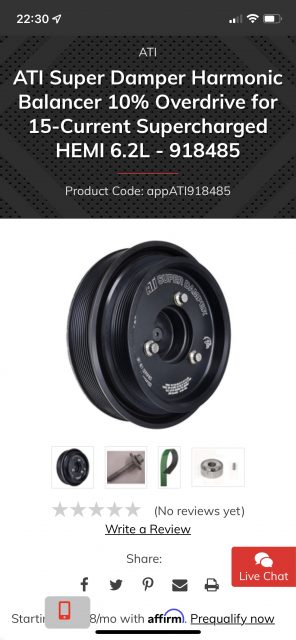

e85 is next, been studying for that tune. Would you recommend this overdrive?

Thats the one I have been running on my car.
With a 2.72 Hellraiser and the 10% overdrive, would you have a guestimate on what the size would be? I know you run a different S/C but if you had a guess?

The ATI 10% overdrive lower adds about 3psi of boost.

Im sorry I meant to elaborate on belt size. Damn iPhones. @Tuckerracing

K100594HD i believe is the belt number for Litens 2.72 and ATI 10% lower
