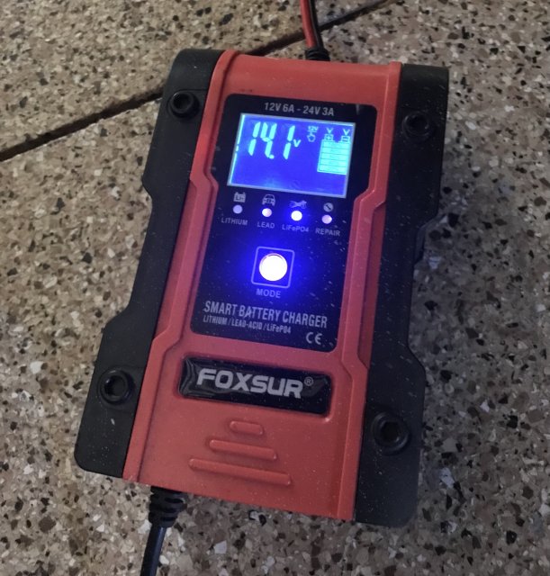

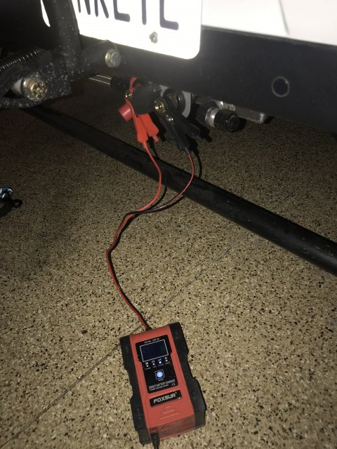

Well crap. Weather's been crap and I've not driven GoManGo in about 6 weeks. Went out to the garage to check it and the Arc Angel battery seems to have lost enough charge that it won't power the car. DMM says 11.38V. I don't think you can jump a L-ION battery.
What do I need, a trickle charger for L-ION to get it back up to snuff?
CEF137A1-E241-4269-9F75-455A74504043.jpeg E460587C-E64A-41AD-A0E8-FDF1246DCCF0.jpeg
Something like this?? https://amzn.to/3JlRXL5

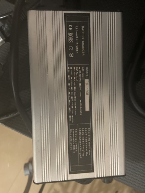

Yes you do. This is the one I’ve had for years and it works great. image.jpg

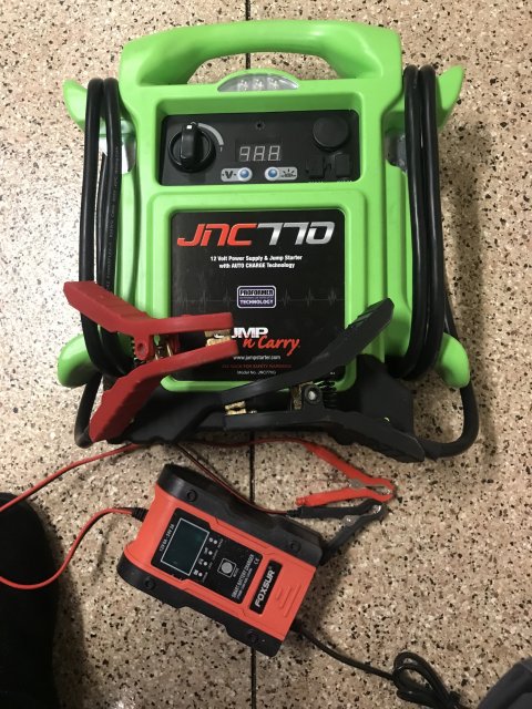

I have the old (going on 4years) Arc Angel. I found that while it was spinning the motor on startup, it wouldn’t fire. That turned out to be the EFI coil packs. They require a minimum of 11 volts or they won’t fire. If the battery didn’t have a full fresh charge, then turning it over was dragging the battery down below that threshold. Those coils are outta here so that issue won’t be a problem any longer. I have a self contained jump starter that is for use at the track. Hooked that up and it fired immediately. So no issues with jumping (so far 🫣). I also have one of the NHRA battery disconnects that help when the car sits. BEE8DC85-023E-4D21-B312-165071EC6AF3.jpeg
