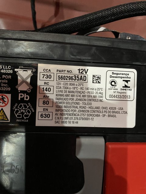

I’ve been casually looking into lightweight batteries over the last couple of years, and by coincidence a Uk supplier was brought to my attention last week.So I just weighed my battery , I didn’t believe how much one could weigh 35.2lb so there is a massive weight saving to be made🤘

Yours is light. Everyone in the states has been 44-52 lbs

Yours would be bigger than mine 🤓, maybe Demon batteries are lighter then, still massively heavy.

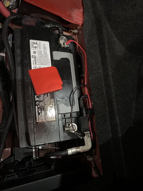

You should post a picture of yours. I don't think the Demons were getting different batteries. Could the battery be different since it was shipped overseas?

Looks like the normal battery. Here is a video weighing the stock battery. Mine weighed 44 lbs also

weighed mine myself also,checked to see if our weights are the same which they are.I’ll weigh it again when my new lightweight arrives ,may video as well ?
