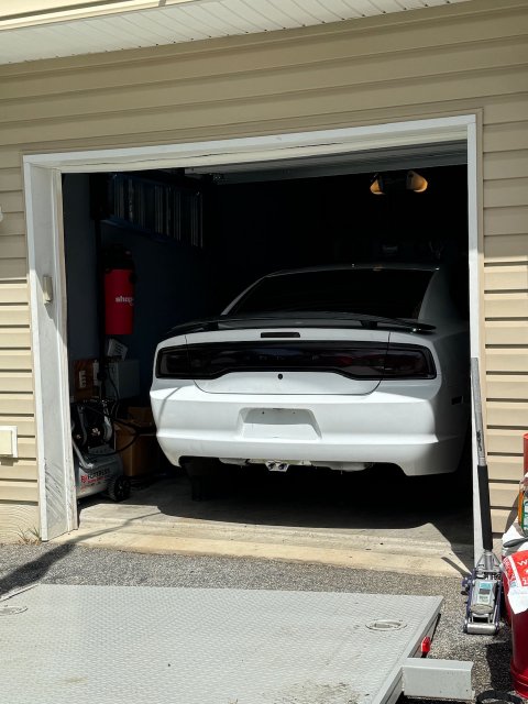

hellcats bitch ass got the boot. Tired of working outside. Btw new hellcat theft deterrent. Ram 1500.

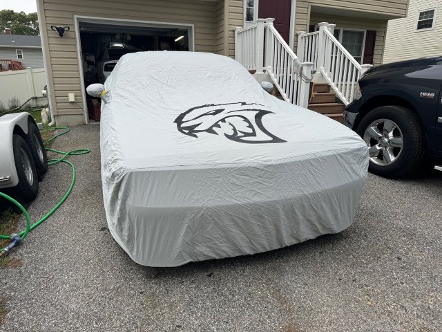

as much as this car burns my soul she got a good cover IMG_2780.jpeg IMG_2779.jpeg
Turn and burn till may 23rd, deconstruction may 24th. Drop off at Jason’s the 25th for cage. Decided to get cage painted white. Black cages lead to third degree burns 😭

Looking good! I need to get a soft indoor cover for mine, insane what car covers cost

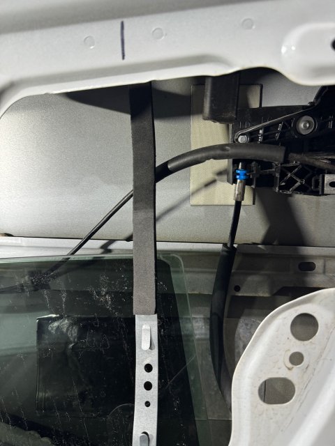

IMG_2823.jpeg IMG_2822.jpeg IMG_2821.jpeg IMG_2820.jpeg IMG_2819.jpeg IMG_2818.jpeg IMG_2817.jpeg

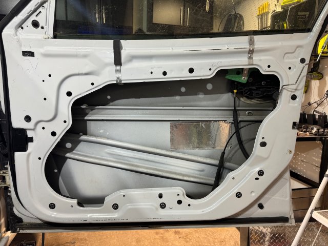

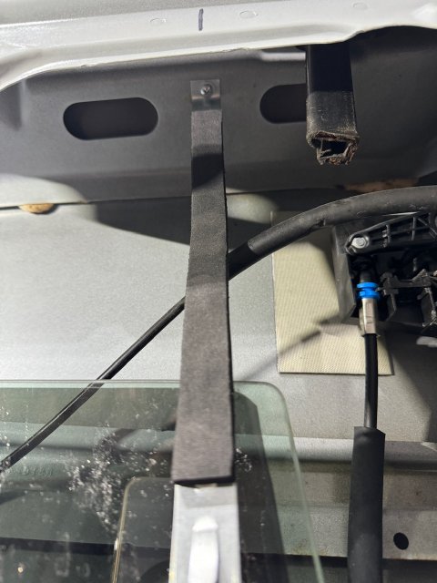

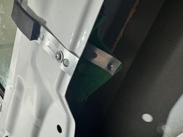

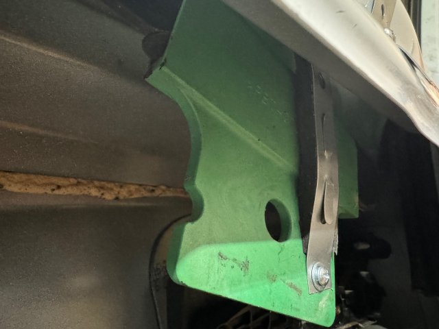

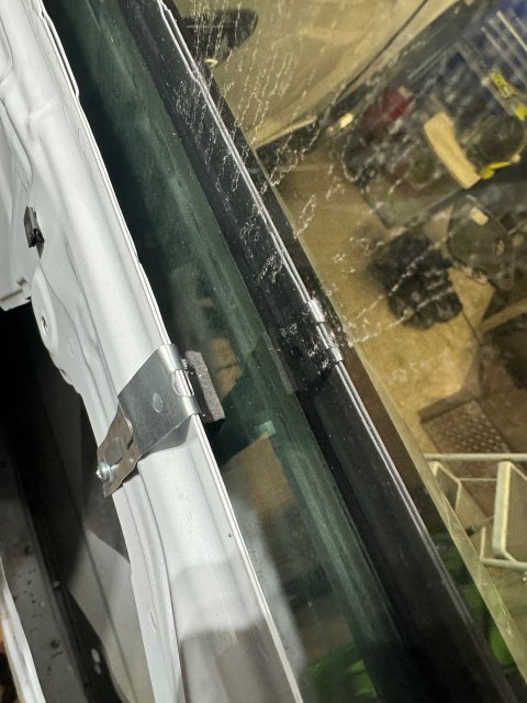

Gutted the doors except the drivers one. Don't need moving windows there. Ordered big sheets of plastic and will be cutting custom door cards. Since this was a police car you couldn’t open the doors from the inside. The hardware simply isn't there. I’m sure there are more elegant solutions but I believe this is strong and safe with the glass thanks to the foam.

Thread Starter #467
Took my time. Cleanest cuts no, rewarding experience though.

Turned out pretty nice

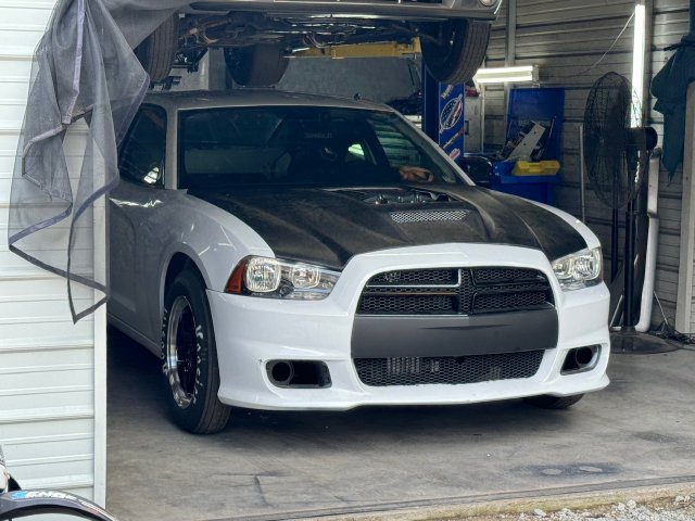

Starting to mount the radiator and lines. Last week I have the car, goes to fab for a cage on Saturday. When I get back we put it on the scales for final weight and then start the process of a first start and idle tuning.

She was delivered to Brazzel Performance and Fabrication. He has some heavy hitters from the MSHS series in his shop right now and his cage work is chef’s kiss.

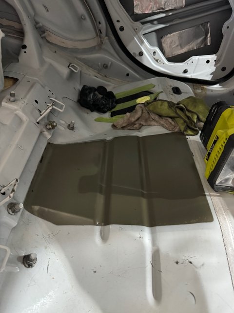

Got home and passed out. Prior to this, cleaned all sound deadening. Shit sucks. Fuck dry ice. Worst method for the price. Heat gun, wooden spoon, goo gone.

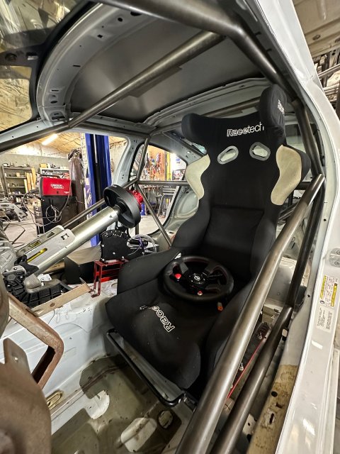

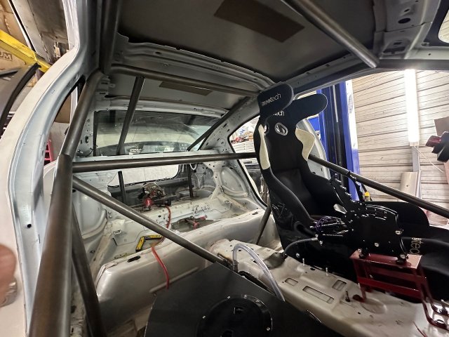

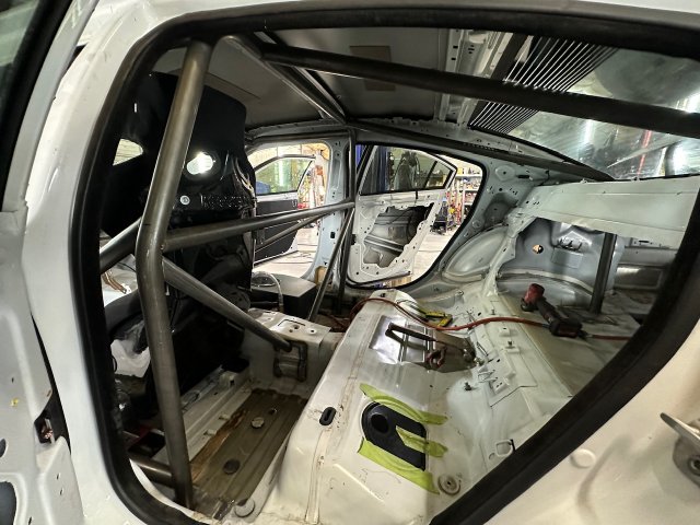

IMG_7635.jpeg IMG_7630.jpeg IMG_7631.jpeg IMG_7632.jpeg IMG_7629.jpeg IMG_7628.jpeg
some progress pics. Bars are tacked in for now but its coming along. I really like how he put the bars through the speaker holes. This is going to help stiffen up the chasis a lot. He did it in such a way so far that we already discussed upgrades to make it 7.5 compliant if I ever get there. 😉

Looks good.. Going through speaker holes is how I did my 87 mustang. Gains more room and looks way better then going in front of dash
Same, looks nicer when finished. Keeps it tight.

Looking good! Plenty of room in the back!

Very nice. This thing will be the perfect 8.60 class car. That class is heating up. Only need the 8.50 cage and even the heavy cars like the Mopars can make the power to run right on a 8.60 index. Heads up racing with no sandbagging. 👊

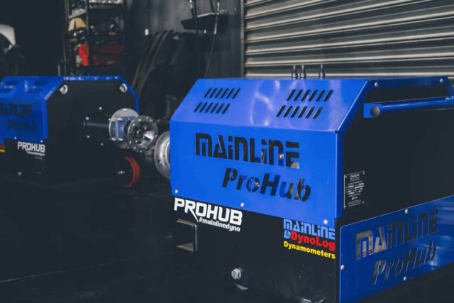

I’ve been cooking… lots of life happens all at once and in a good way. Im helping a great friend of mine realize his dreams and in turn I get to realize mine. I am now the proud owner of these.
Mine are currently being built and will ship soon’ish. I fly out for my Holley courses in two weeks and I pickup my race car Sunday from fab and on Saturday im having lifts installed. Im sure y’all got lots of questions but the car projects will be on hold temporarily till I get the dyno business up and running.
Rates are competitive
I am remote tuner friendly
Located in Annapolis MD.
Ant’s Efi is a thing and well here is a potential company logo
cant wait to show yall pics of the cage, it looks amazing 😉 cant wait to get the hub dyno in
lots of things to do, been hustling my ass off these last few weeks
