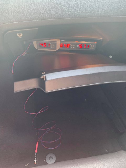

Check out our latest testing. 0-80 pull on the street 27* delta full boost, proving once again stock pump 2gal water and Chiller all that's needed. Will have more detail after Cadillac Attack.
before and after chiller and after reservoir/pump

Anyone seen this? Active Interchiller the only true plug n play, only nothing cut, only automatic HX bypass, only complete with wiring, only one with a true money-back guarantee, If you're not happy get a refund and keep the kit. No Ice Guarantee
Advertising your products on a help thread..:unsure::unsure::unsure::unsure::unsure::unsure:
