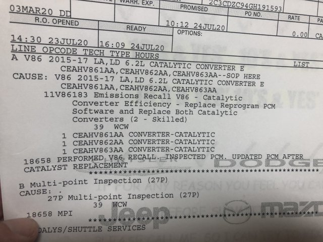

Just picked mine up, looks like it was 2015-2017. Looks like they replaced the pcm and the cats. My exhaust tone is noticeably more mellow than before. If you’re not having emissions issues like I was I A9611A0F-0415-4D0F-A242-674D7B117B2B.jpeg would think twice about it.

sounds like they might refuse the physical parts of the recall if you said no to the reflash (that's the "reprogram" part). Anyway really had just the cats and sensors replaced?
