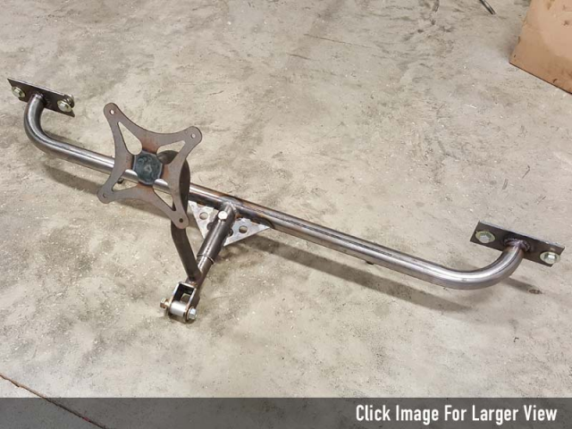

Just make sure he has it come out down low enough so you can keep the plate on the car 😎
Think the plan was to do it behind the plate so the plate covers the hole. The parachute bar can be unbolted from the main bar so you don't have to drive on the street with the chute on the car. I had that set up on my 87 mustang but never used the chute

This is for a mustang but will be something like this

Gearhead sells one like this for $500. Any idea what one will cost for us? I know for mustangs they’re under $300

I don't know what his plan was on price

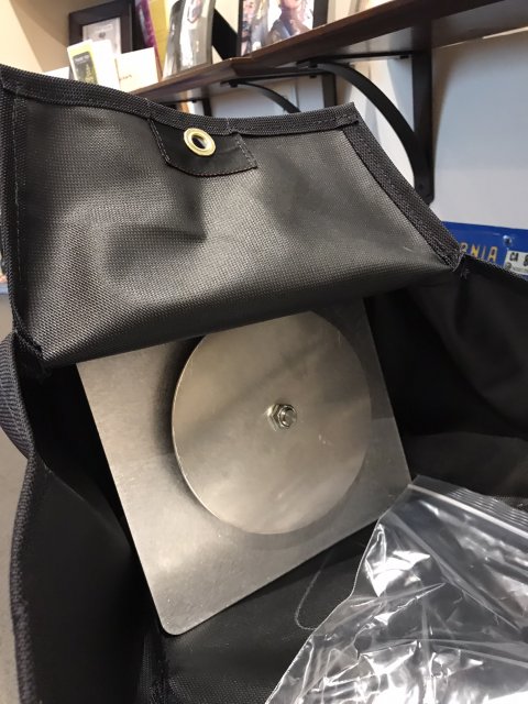

On the subject of chutes for those who have yet to experience the joys of using one……. You will very quickly come to hate that thing. The chore of repacking it with that mfr of a spring pilot chute will keep you from using it unless you feel like you really need to. After having done that a few times, I upgraded to the more expensive air launch type. That employs a small CO2 bottle to pressurize a ram that pushes the chute out in what is called a deployment bag. The bag has flaps that open once out into the air and act as a pilot chute and eliminate the need for that compressible spring that is used to drag the chute out with the standard system. While struggling with getting that spring compressed into the pack and closed, there will be many select words being used in the process. There is none of that with the air system. It’s a piece of cake by comparison. Some pics…. 😎

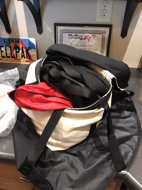

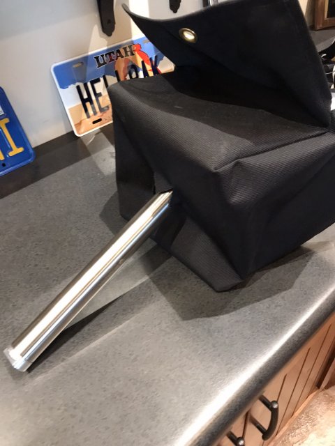

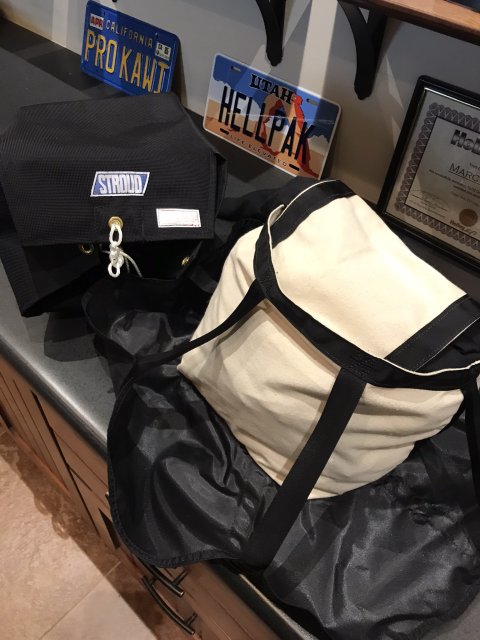

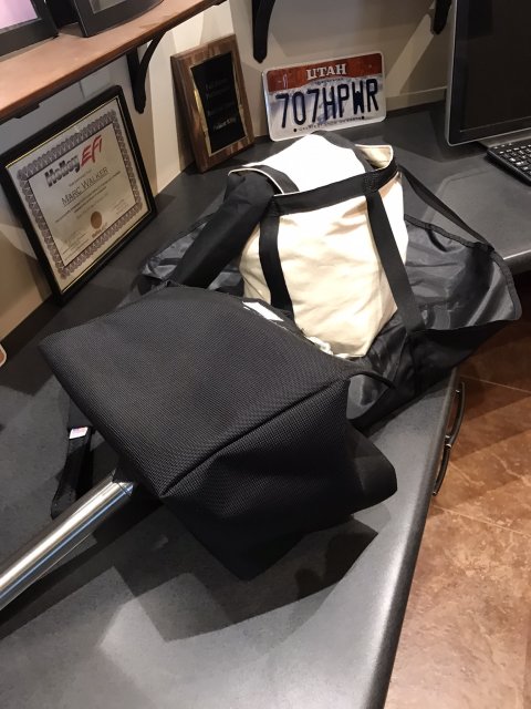

An air launch setup is way easier but I've had to pack my spring loaded chute so many times, I've come to just accept and have gotten quite proficient, with or without help. It has become such a non-hassle for me that one time, I decided to work on packing the chute while I was in the tech line waiting. It was the last night of racing at Houston Raceway Park and the tech line that wasn't moving very fast and was extremely long,. I got it done in 2 moves while entertaining everyone else at the same time.
Yes, it sucks at first and may suck for a while but do it enough times and pick up enough tips, tricks, and technique along the way and it becomes a lot less of a chore.
Here's one big tip I picked up from a pro crew chief and driver team that I used to tune for. Once you pull the string and loop through the first hole, you or someone helping you can hold the loop in place and keep the spring compressed by simply pressing your thumb against the loop that you just pulled through the hole. Doing this alleviates the need to continue keeping the spring compressed by whatever method you had to use initially. Thumb pressure alone will be more than sufficient and it makes the rest of the process super easy. After pulling the string and loop through each hole, put your thumb on it again to continue holding it in place as needed.
It also helps to pack the chute neatly into the deployment bag. Don't just stuff everything in there, it'll fail to deploy more often than not if you do that and it'll also take up more space making it harder to pull the loop all the way through. More often than not, I had failed deployments when someone else did it for me to try and help out or my wife decided to follow her own directions on how to pack it into the bag.
Another tip I picked up along the way is the use of clothes pins to keep the parachute cords neatly bundled together. Once I stretch out and untangle all the cords, I use 4 clothes pins to keep them perfectly layered so that I can neatly stuff the deployment bag without having to do much work keeping it neat and bundled.
@fumanchu182 may have seen me do some of this in Maryland last year? Maybe not, but when I get time, I'll do a video.

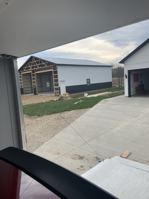

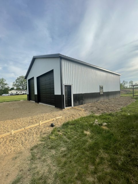

i just ordered a set of manton valve covers. Need to figure out a set of heads next. The shop build has somewhat been limiting my speending. But it looks good.
sitting right next to my house.
Out there on the prairie...
