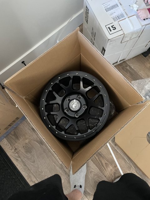

New wheels for car trailer so they match the car:geek:
hahah that man putting bead lock on the trailer!! shewwiee that's how you know its a race car!!
60,895
212,603
They are just some small 15s with a beauty ring that bolts on for looks. :)
