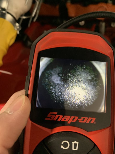

I'd scope it to see if you can see anything.
Well the only note scope I got my hands on was a snap on one and I struggled to see much

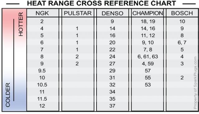

60,921
212,688
According to Bosch cross reference a 6,7 bosch is the same as a NGK 6. Most plugs getting colder the higher the number, bosch the lower the number is colder
Shows a NGK 7 is the same as a bosch 5
60,921
212,688
That was the chart I saw

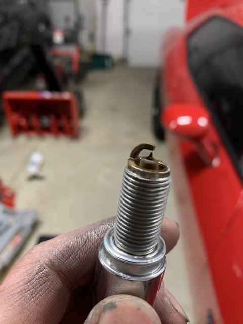

@Speedy! i know how much you like octane boost pics.
I had some in the car because I ran it around on 93 a bit for storage and put octane booster in. Well just have backing out of the garage and running it. Here is a brand new plug with 10 minutes of run time.
5,205
9,661
Looks good to me

5,205
9,661
Just stained a little bit nothing crazy.
I hope your #4 recovers for ya.
How much boostane did you use ?
I normally use 2 > 2.5 oz. to 8 gal.

I don’t remember. I think I just dumped some in because I wanted to get a few last pulls in before it snowed 😂
17,288
54,097
10min on a new plug?
Looks dirty to me...
So the verdict is the NGK plugs you got is same as stock ?
.01
I don't think they stay new & shiny looking very long.
10 min. of hammering down :LOL:
I beleive they are a step colder. Look at the chart I posted. The ones we bought are Ngk 7.
OK the NGK 6 would be same as Bosch 6, got it.
4,385
10,906
Thread Starter #518
It is more confusing than it has to be. If it helps here is the part number from my stock plug Fr7s1332
5,205
9,661
I know right, thanks.

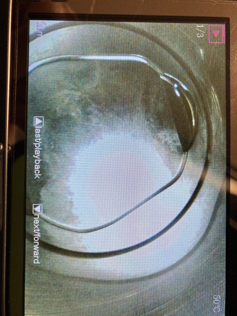

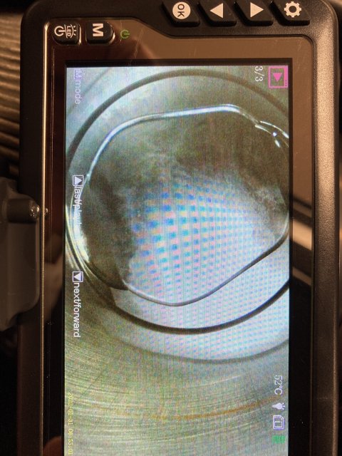

3,752
8,909
Need one like this, and this is a picture of the picture on the scopes screen, with the protective scrim still on it!! . Camera resolution is 2180, and it takes movies too! Articulates 360 degrees 7525A4A3-3E20-485A-A233-6DCCF6CCECC7.jpeg 7083F35E-BC04-41DC-A138-4AA88E009DF4.jpeg
