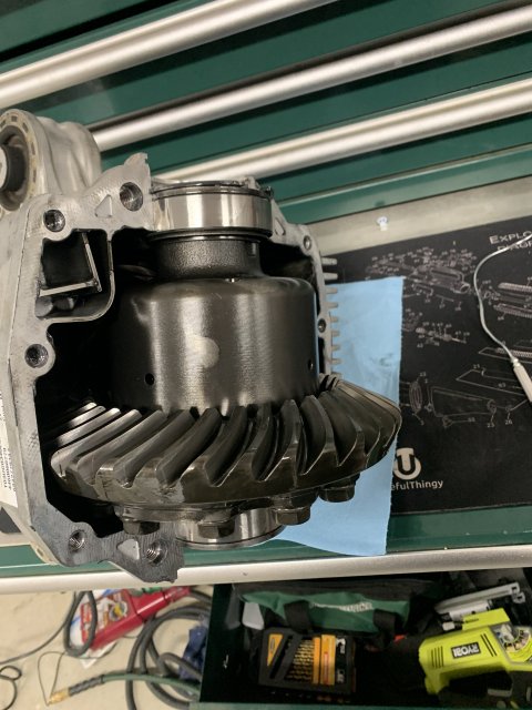

I'm going to open the diff to look everything over as well as try and get the axle out that way.
When putting back together is a new OEM gasket instore and do I have to use anything to put over the gasket like Tribond?
IDK......but take/post a bunch of pics.

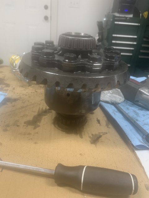

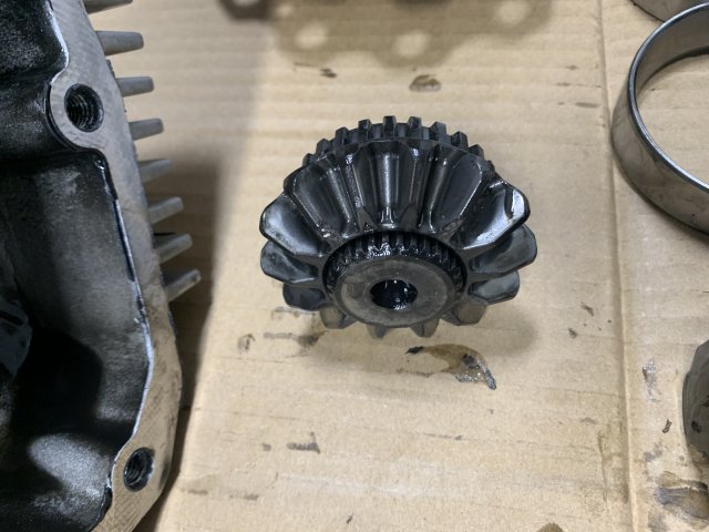

So the axle is out. I split the case tore it apart.
next time I’ll just do this. Way easier than all the time I’ve wasted.
I have to finish putting the diff back together.

What are your thoughts on using this Diff or not?

To me everything looked in fine shape.
