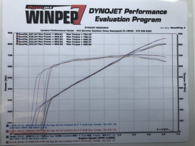

Here’s a before and after for you guys. Dyno’d 2/17 before adding a FAS Billet plate to my 2.4 IHI blower, avg 3 pulls 806 hp. Installed FAS Billet inlet plate, hand port matched my snout with a 2.85 Litens already attached, bolted on a Fastman 95 mm TB, no relearn no tune change, didn’t even disconnect the battery, picked up a solid 50 HP and 20 ft lbs TQ. Added 3 MPH to the top of my 1/4 mile time.
