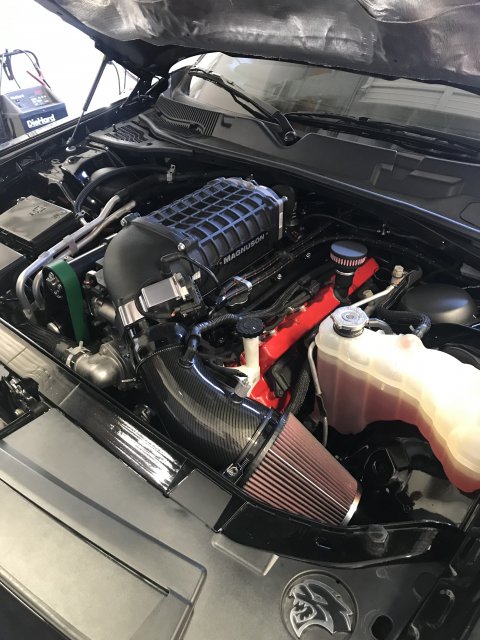

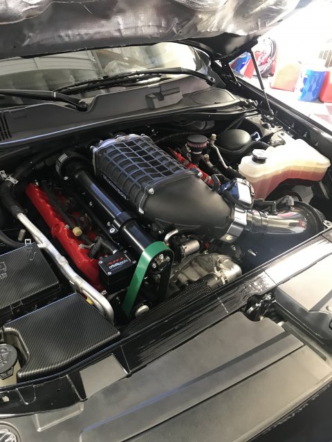

57200CB8-FCEE-4504-9A00-AED55A7C6609.jpeg C17A6BF2-2792-4403-B9D7-665E5316C939.jpeg
Getting it ready

Last 2 pulls I will go live. First pull cut out at 4000 rpm so Tim and tommy are make some adjustments. Gotta load up the ice box.
826 rwhp -978 torque on first pull
11,025
It a good thing you are not making any torque .
How much boost?
Primetime Hellcat 17
#949
687
974
2017 challenger Hellcat
Thread Starter #56
How much boost? When it cut out at 4000 rpm
1st pull was at 20psi when it cut out at 4000 rpm

Well couldn’t go live on IG lol poor service.
Update though we had belt slippage going on so we ordered another belt tensioner to eliminate that issue. Will be here next week and back on the dyno as well.
