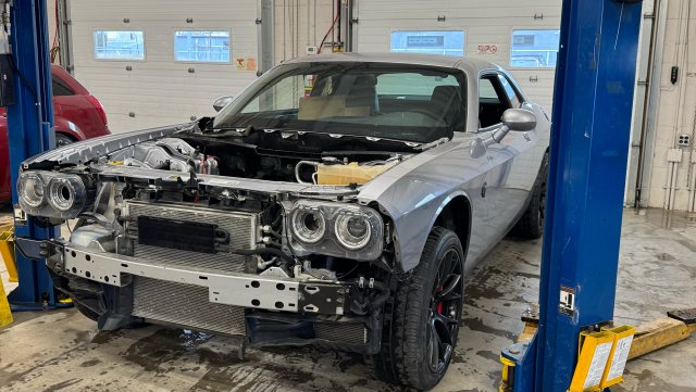

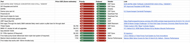

It's been a while, but I'm back and ready to light more money on fire in preparation for actually having a race season this year.
I spent the tail end of the year driving the car around with the TH400 in it, and quite frankly I hate it. To be fair it never really got a fair chance, its just kind of stabbed in there now, enough to work, but not be happy. I think that along with the fact that my friend specced a 3800 stall, super loose converter hasn't done a whole hell of a lot to make me enjoy the way the car drives.
So that said, I'm going back to an 8HP90.

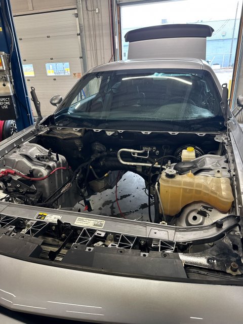

While putting the TH400 in, we figured out why we had been having so many weird issues with the car. The shop that built it for the previous owner hacked a ton of wiring in the stock harnesses so we have decided to rewire the complete car. I now have new factory engine, chassis, dash, and interior harnesses to put in the car. I have also ordered up an 8.50 weld in cage kit, parachute mount and everything to put a parachute on the car, OST Dyno Demon plus cam kit, new SFI flexplate and arp bolts,and an SHR demon converter. Next up will be to order an MMX 411 stroker kit, and Thitek heads.
The plan is to strip down the car, get all the new harnesses installed, get the cage welded in, parachute mounted, pull the engine apart, get that rebuilt with the stroker kit/cam/heads, stab an 8 speed back in it and get it all tuned and set up. I should have enough fuel system and have the rest of the suspension work etc already done, unless I go to coil overs and take it from there. The idea is to run 8.50s as I don't want to go any further than that cage/chassis wise.

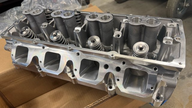

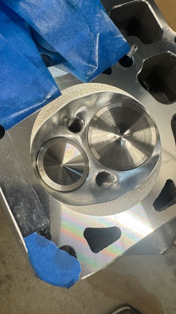

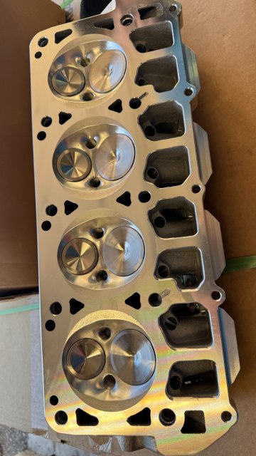

Got the Thitek Bear heads ordered and some other misc parts. Stroker kit will be ordered soon, I'm between the MMX 411 and 422 kits, from some research it seems as people prefer the 411 on a boosted application so I'll likely go that way, but am open to suggestions if people think otherwise.
What are the best header gaskets for these things? I hate exhaust leaks and have long tubes, I want to make sure to use the right gaskets to have them seal right the first time. The last thing I want to do is be taking those things in and out.
OEM, you won’t have enough clearance to fender with other gaskets. Just installed the 2” HHP kooks and have almost no space. They will seal.
i went with a 426 kit, go big or go home! 😂 in regards to the gaskets, cometic, felpro or stock are all good

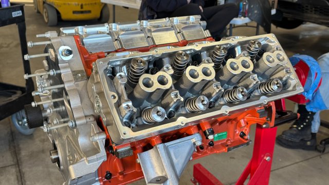

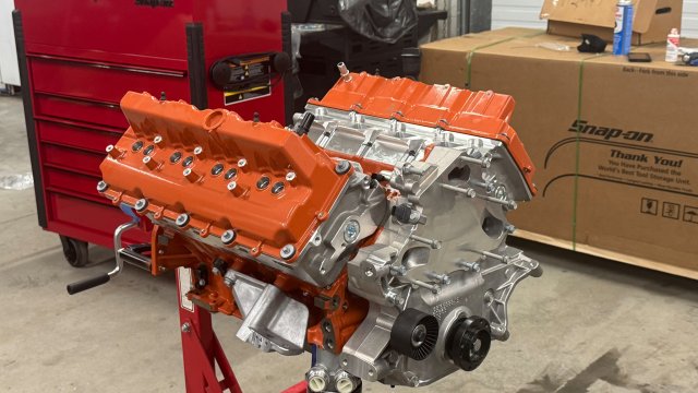

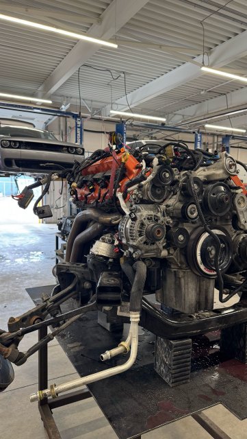

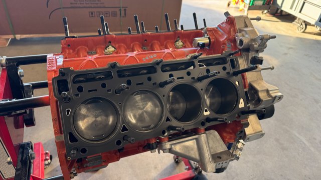

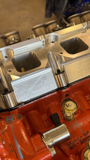

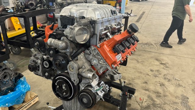

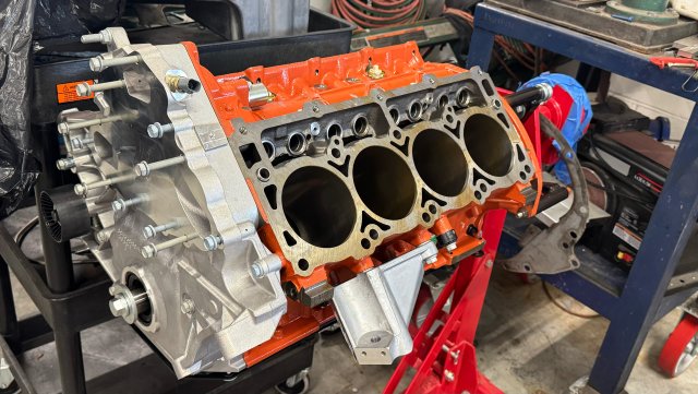

Finally made a bunch of progress over the past few weekends. Engine and trans is out, all the wiring is stripped from the engine bay, and the new engine has started going together. Brand new BGE block, all new bolts and sensors, MMX 411 stroker kit, Thitek heads, OST Dyno Demon plus cam, ARP hardware, etc etc. Just waiting on the trans and converter to come in to wrap up the powertrain work. Also waiting on the pre bent cage kit to arrive to strip down the interior, weld that in and swap the interior harness out. I've got the old engine up on Facebook marketplace and am trying not to blow my brains out dealing with all the dreamers lol.
