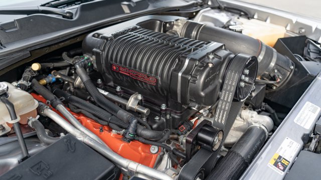

Hey guys, I'm new here and thought I'd start a build thread for my car.
This is my 2015 Challenger Hellcat I bought about a year ago. When I bought the car it had Longtubes, catless mids, 3.09 gears, DSS aluminum driveshaft, diff brace, Fore fuel hat with twin hellcat pumps, ATI 10% balancer, Alky control meth kit, ID1300 injectors, and a 4.5 Whipple. You know what they say about buying someone else's project, I spent the rest of the season trying to get the car sorted with the help of Mike @ostmike (remotely), and during that time added a Whipple big oval throttle body, Fore fuel rails, flex fuel sensor and gauge along with a few other things. The car suffered the weirdest issues, and after finally getting the car flashed back to stock with a WiTech and giving Mike a stock file to tune off of, instead of the mess of a tune that was in the car when I bought it we finally had it up and running. Right when we finally got it decently dialed in, the season ended.
I got the car out to the first track rental this year, and the car ran strong first hit, going 9.82@143 MPH with minimal cool down. I sent the log to Mike who sent me a revised tune with more power in the leave and more timing throughout as I was running a 50/50 93 Octane and VP Q16 mix, but unfortunately we never got to see what that would do as the blower ate a bolt immediately after my burnout.
Upon tearing it down it appears that whoever installed the blower initially didn't locktite the bolts holding the intercooler to the lower manifold, they loosened off, and the one directly under the bypass valve got sucked up through the bypass, and directly into one of the rotors. I checked the adjacent bolt, and it was loose as well. I had originally planned on building a stroker motor last winter when I first bought the car but after fighting all year to get it running right I wanted at least one season with it before we started from scratch. I have a Whipple 3.8 on the way to replace the Whipple 4.5 that was on it and will just have to keep it turned way down this year to keep the bottom end in tact. Barring any unforeseen circumstances, the car will get a 426 or 411 stroker over the winter, along with a TH400 and a cage.

Will be fun to follow a long. I've heard of more than one of those 4.5L Whipples eating bolts from random places unfortunately. Buddy of mine had that happen only the bolt made it past the rotors and trashed his brand new 426 :(
3,496
11,247
Yep. It was a concern back when the 4.5’s were starting to show some promise. Apparently a number of those got out of Whipple without those screws getting the locktite they needed. Remember WhipCat here? He had one come loose and it got kicked back into the throttle body on shutdown and lodged in the blade. He lucked out. After seeing that I pulled mine apart and did what was necessary.

Had a hate/hate relationship with my 4.5, horribly designed manifold in and out
3,496
11,247
Spacer to increase plenum volume and some minor tweaking to the intake and they work great. 😝 BA23463E-8F1E-4018-BA9A-F2D4C2968F52.jpeg

Spacer to increase plenum volume and some minor tweaking to the intake and they work great. 😝 View attachment 105849
I wanted to do this to mine for the rear plenum, saw it on a green challenger hellcat years ago
7,726
6,534
Shouldn’t have to modify a $7k blower/throttle body though

That was the blower on the Grinch. We still have that car and it will be coming out of retirement next year with a 3.8. It was the fastest full weight Hellcat in the country 5 years ago. Ran 9.1 with that Whipple when nobody else in the country was out of the 9.4’s yet. Nichole was 18 when she was unbeatable in that thing. 0D1E01E8-69DA-4520-8776-175CA8AE79D3.jpeg

That was this blower on the Grinch. We still have that car and it will be coming out of retirement next year with a 3.8. It was the fastest Hellcat in the country 5 years ago. Ran 9.1 with that Whipple when nobody else in the country was out of the 9.4’s yet. Nichole was 18 when she was unbeatable in that thing. View attachment 105855
Thought it looked familiar!! Didn’t know it was yours!

I used 1/4” spacers on my front k member to drop it engine down low enough for 4.5 to clear hood with FI spacers, only way I got manifold #2 to seal. Still had to remove the flame retardant on the hood and notch part of it by the driver side washer hose. My wiper arm is still bent from original install lol

I still have the spacers, makes changing plugs a bit easier because it drops the passenger side out of the way of the PDC wires/plastic shroud covering them on passenger side strut tower. Was going to take them off but they level the rake of the car out which in my mind says is better for weight transfer but who knows
