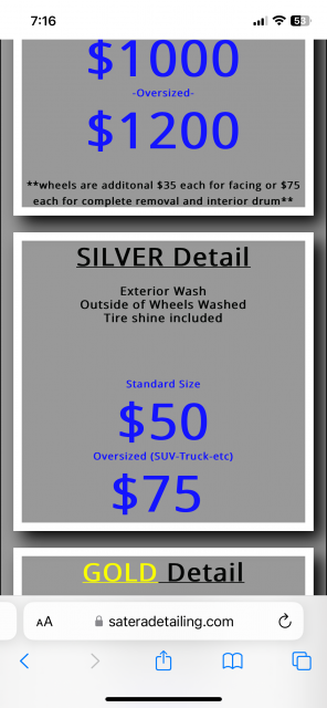

Exactly, and @covidcommander did the right thing and seems like he got a full quote up front showing the $$$$s.
Now he can be use it to compare prices and just like he is doing and is asking forum members for opinions.
But sadly HE just won't be able to get that upgradable Silver Detail Option :p
4,381
10,904
because I was curious what silver was. Dang they don’t even clean the inside of the wheel. Shoot.
6,139
40,336
Well, there ya go.....We Now know they Do a Half ass job!
