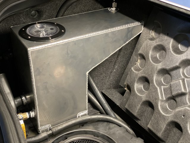

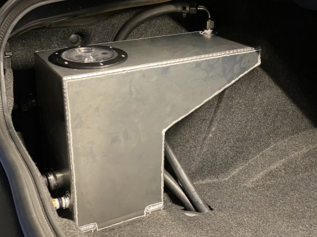

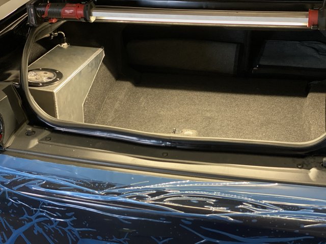

BDEC2936-DF5F-4B2A-B525-E10ED6601158.jpeg 7798D637-DE13-4E43-86D4-80CDD49BB0FD.jpeg 97D0C731-3FCF-45E6-A82C-DCA7854DA360.jpeg
This is what Tommy came up with at SRT AutoWorks. No way in hell I was taking out the subwoofer. It looks nice and clean.

View attachment 12836 View attachment 12837 View attachment 12838
This is the box to have if you want to use a chiller. My FI Interchiller works best using my ice box with about 2 gallons in the tank. That gives me the fastest and coldest temps. Problem with the flat “Charger” version (that I have) is that 2 gallons barely covers the pump intake and any deceleration uncovers that and sucks air. That won’t happen with this “Challenger” version of the tank. To be honest... before going with the interchiller I don’t know which way the coolant was moving thru the exchanger. I don’t know that it matters. I have now removed the exchanger and closed off the inner opening in the fender well that allows the air to move thru it, so that air duct is now functioning as a cold air inlet for the supercharger. After I get everything else done, I may change over to this tank to get that increased efficiency with the interchiller.

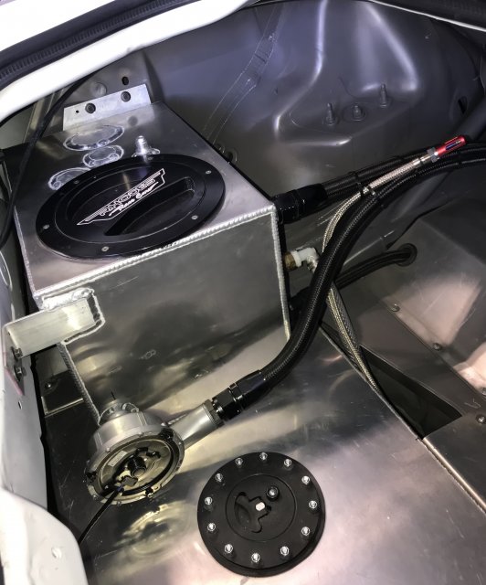

Yes. Too big to even be a option with the side mount PNR. This is what I’m using now. A custom 10 gallon tank. 0D791369-DB17-4368-BA2D-9E8072C5ACAE.jpeg

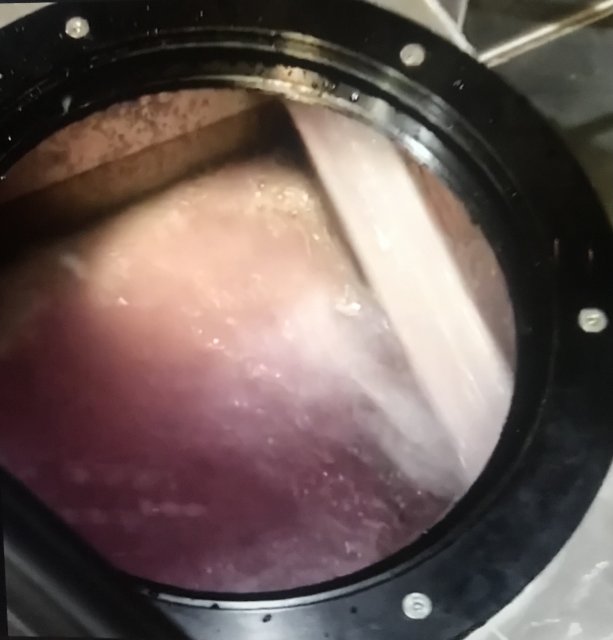

Screen shot of a video showing the flow of coolant returning to the tank with the 1” lines and 40 gpm pump. AC2B8513-D2D1-4BE4-9997-11D86F58AA89.jpeg
