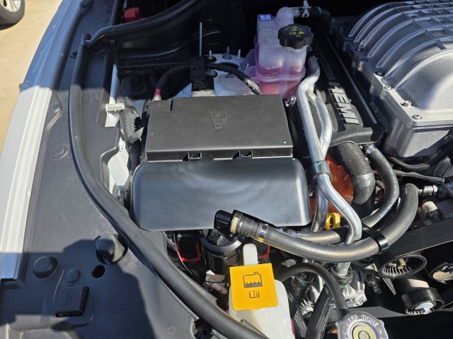

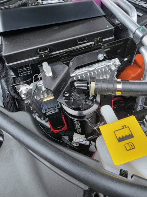

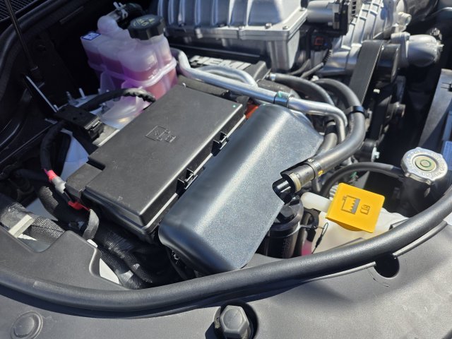

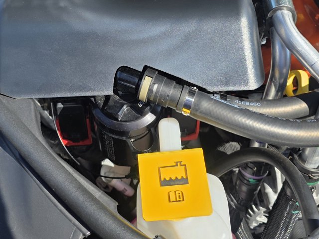

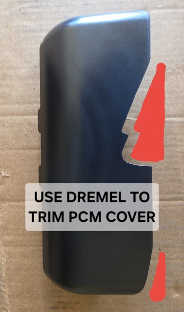

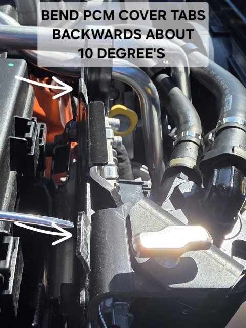

Installed the Improved Racing CCS Oil Catch Can Kit on the DDHC Jailbreak. The kit does not come with a dual hose separator clamp, I highly recommend one with this kit to keep the hoses in position. I also modified the PCM cover so that it would fit in conjunction with the catch can. The instructions for the can doesn't offer any advice for reinstalling the PCM cover or how to modify it. After trimming the PCM cover, I also bent the tabs that the PCM cover secures to backwards about 10 degrees. See photos...
