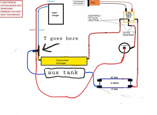

I'm going to plumb my setup the same way. It will either run through the oe exchanger OR the chiller. I don't think I'll do the refrigerant valve on the chiller side. Yet. My thought process is if I do need max a/c, I can put the 3-way to run only the oe exchanger. Since no coolant will be flowing through the chiller, it will reach superheat (or supercooling?) quickly, and start closing off the chiller txv, leaving more cooling power for cabin a/c. Chiller won't freeze over, so no worries of the chiller slugging the compressor? This is my sketch, adapted for trackhawk and no aux tank.

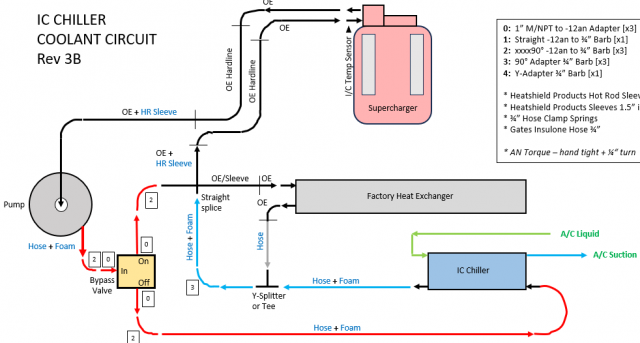

Not sure I’ve seen this diagram before, where did you get it and how old is it?
fubar569
#1073
1,419
2,079
Bradford
That appears to be the much cleaner, well drawn up and semi-official version of how mine was set up by allpar garage.
Told y'all I sucked at paint & photoshop. Lol

if I was to go this route where would the aux.tank be patched in?

Sorry, that drawing is not an official IC Chiller layout. Just me trying to make sure I plan my install properly.
The same as in your sketch. My diagram will work just like yours. Either oe exchanger OR chiller. In your case, oe exchanger OR chiller+aux tank.
