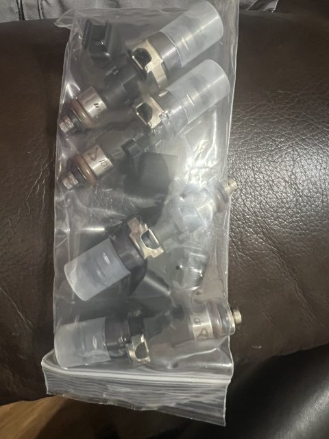

If I went to the 1700s what is the fmv of the 8 1300s if I let the buyer pay the price of cleaning all 8 and fixing that one injector?

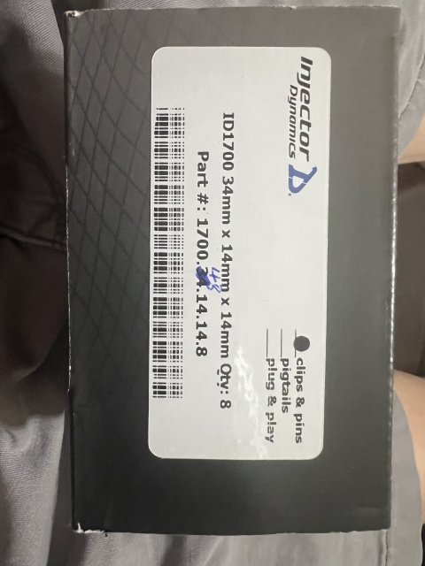

The id1700s will be here on Monday and I should be rolling with my new tune next week. I am going to sell the 1300s for 525 including shipping to the continental 48. Figure even if ID cannot fix the bad injector you would be paying 525 plus 250 for a new injector and 350 for the labor to clean them/flow test them, etc. 1025 vs paying 1800 or so for a new set.

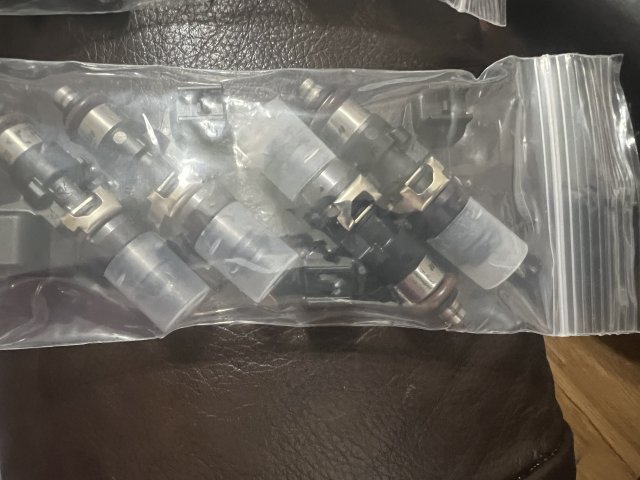

Should I worry that the plastic protectors were pierced?

Weird. They crossed out 24 and marked 48

I hope they do not need cleaning. They are supposedly brand new.
