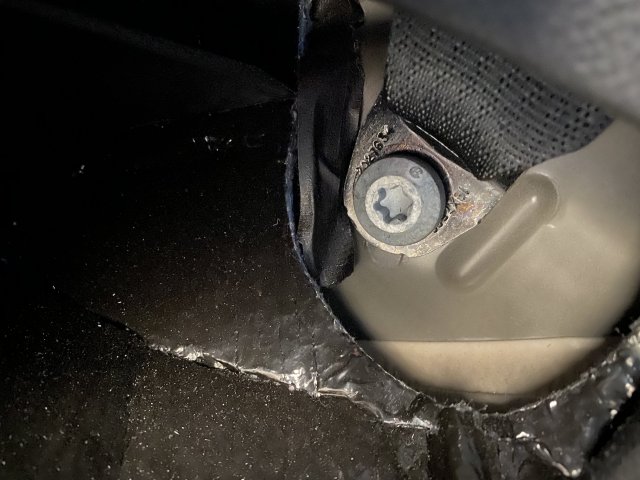

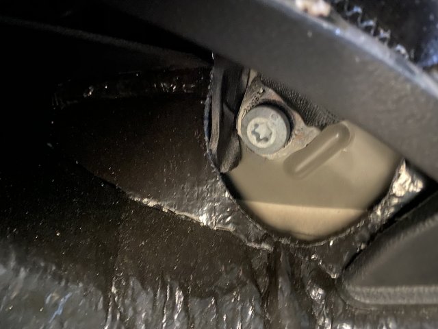

Anyone else having a rough time getting the T50 star bolt out on the bottom of the seat belts.
I’ve tried everything and they won’t come out.
I watched speedy’s video on it as well.
Any tips on how to get them loose?

I was able to break mine loose with just a 3/8 breaker bar. Once I got a few turns on it my 3/8 DeWalt impact spun it out no problem. A few of them were tough.

Just slip a pipe over your ratchet. Floor Jack handle, whatever. They will break free.

Them are tight with lock tight on them I had 2 slightly used T50 lisle bits broke them the rest of the way. Harbor freight junk tools in most cases but with a 3/8 breaker bar got them loose then did my rigid impact to finish it up. Good luck!!

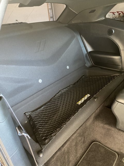

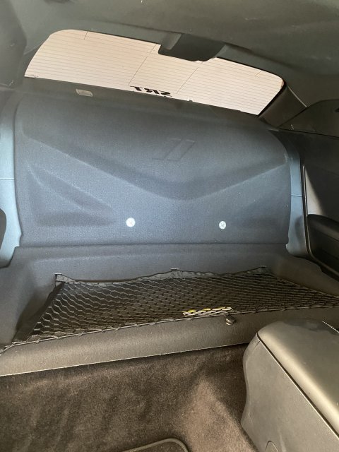

4C5864AC-6582-4E31-98FB-EF842CFF5E9D.jpeg A93C78AF-CCC3-4700-B7AA-928362EE53DF.jpeg
Finally all done! 6”1 and about 220lbs I’d say screw the install lol. Overall looks good. Quality of the kit I give it a 7.5.
Anyone else that does the install them selves be carful of scratching the panels when you pop them off to remove seat belts.
StinkEye gave me a heads up to remove the passenger seat. That made it much easier to install the kit.
2,580
7,114
Thread Starter #160
Looks great. Nice job.
