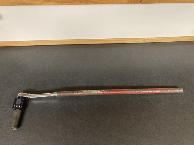

Here is my new $38 digital long handle 1/2 drive torque wrench. Even comes with a cert of calibration! Seems to work pretty good! :)

I’ve got one and was about to suggest it as an alternative. I used mine to check and calibrate my cheap torque wrenches. Haven’t used it to tighten lug nuts directly. Supposedly very accurate.
The instructions are atrocious. Is there a way to store the target torque values? All I can find is a way to store previous torque peaks, which seems pretty worthless.
I just set the torque I need and listen for the beep. It should hold the setting while you’re using it. (Clicker wrenches are supposed to be stored at their minimum setting, anyway) All I’ve used it for is calibrating my wrenches. Maybe some YouTube videos can explain any other capabilities.
My old Craftsman beeps when reaching the set value.
Not sure it can store anything, but then again, "Jack" and "Derek" had nothing to do with mine since I don't think Harbor Freight existed when it was made.
I went to tube, nothing of value. The adapter has the ability to store peak values, and other things I cannot understand. I had hoped I could store the desired torque values for the things I typically use it on, but I guess that is asking too much.
My theory is that the people writing the software specs and writing the actual sw have never actually torqued a nut. This theory is universal across all disciplines and industries.
But for the price, I am happy! :)
