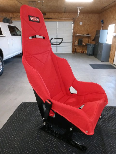

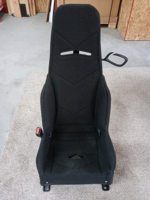

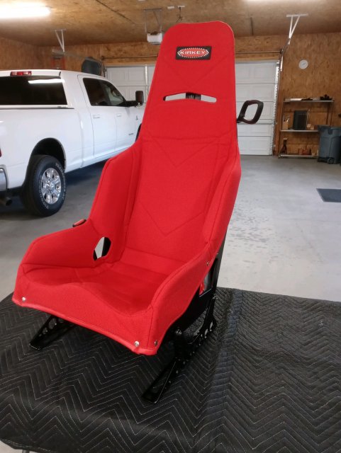

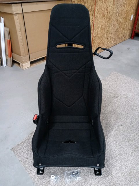

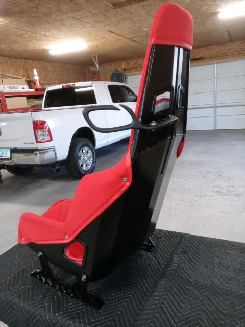

Just finished making this setup for a Demon. He approached me at Irwindale and I said I would do it. This is an 18.5" and it weighs 20.2 pounds complete ready to bolt in......17" is a couple pounds less.

TYVM for this info Ron. Very thorough and very helpful.

TECH TIP : Sometimes the side of the seat is not square. So, the seat brackets will be splayed outward. If everything is just right the seat will just drop right into the car and the bolts will go in EASILY. So, now as part of my build process one of the last things I do is lay the seat on it's side on a moving quilt on a table top and measure the distance between the bolt notches. I have found that the 18.5" seat is the worst. I assume it's because the brackets don't use spacers with this setup. The brackets are usually splayed outward and that dimension is over by about as much as 3/4" ! It should be 16-1/2". So I carefully bend the brackets by pulling downward to get the 16-1/2" between the notches. I bend each side equally as I can. Be careful and don't over do it.
Also on the fit. I am 5'9" tall and 185 pounds. I sit in a 17" and I feel right at home. If I sit in a 18.5" it's like OMG way bigger. I don't like it at all. So it's quite a bit bigger on the fit. They also make a 15 and a 16 and a 20 inch wide seat. These brackets would not work with the 16 or the 20" but likely would work with a 15" if you turn them around. Best thing you could do is if you KNOW someone that has this seat is go sit in their car. If you are around me just ask. If I am not around my car at the time then just go for it. I won't mind.

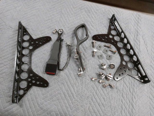

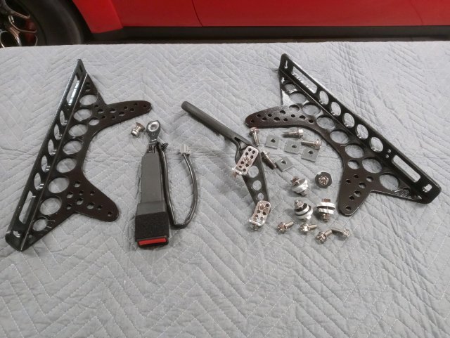

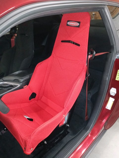

Everything needed to put a 17" or 18.5" Kirkey Drag Race seat in a Challenger. All TI Bolts. Buy the seat and seat cover from Summit.

Ron is the man, helped me a lot with my kirkey setup. I would buy this bracket setup in a heartbeat, way lighter than the setup I went with (lack of a band saw/drill press)

Hey, what brand are the seat brackets? I purchased a Kirky seat 18.5. I have a hellcat challenger. also, how is the height after the seat is installed?

Phenomenal job what type of seat brackets did you use and where can I get them?

Phenomenal job. Where can I get those seat brackets?

Hey, where can I get those seat brackets. The seats came out very nice. Good job.
The height is fine. Of course it depends on your preference and how tall you are etc. I do not use the full height of the uncut bracket. If you look in that layout photo you can see this......

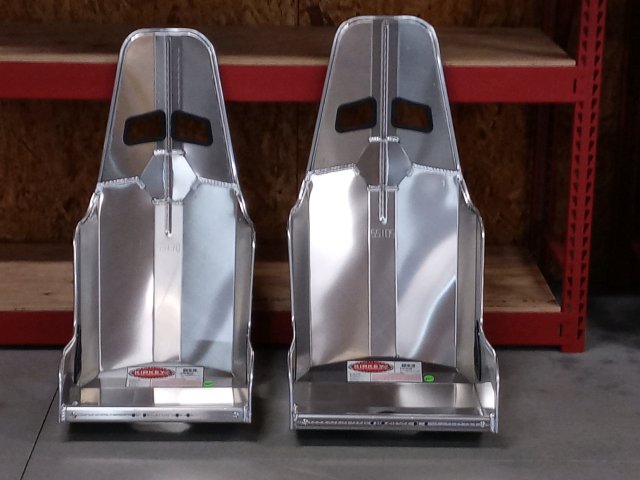

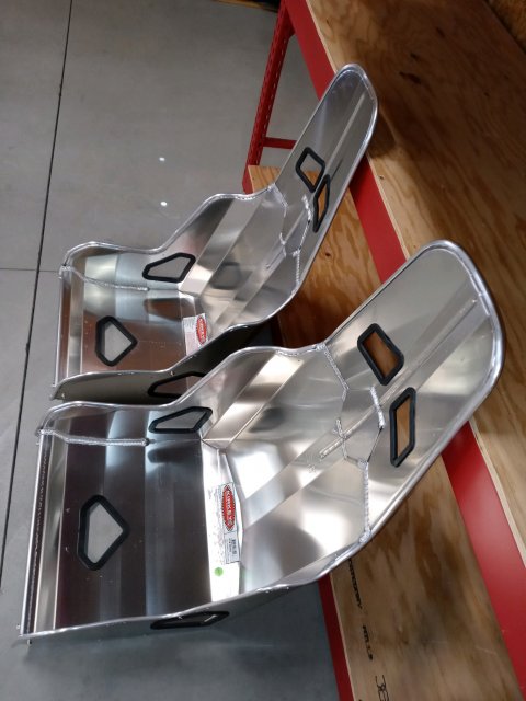

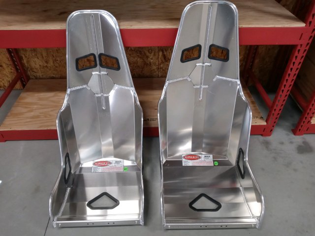

Putting together a couple more setups for Racers and I happen to have a 17" AND a 18.5" Seat side by side. The 18.5" is larger in every dimension. Not just width. Sitting in it, the 18.5 feels way bigger. 17VS18.5 1.jpg 17VS18.5.jpg 17VS18.5 2.jpg
