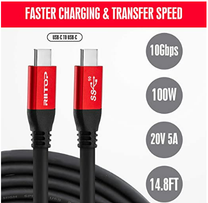

Here's the cable I purchased; no issues of connectivity whatsoever. Had to purchase a USB C to USB adapter for my older laptop, but other than that, this works perfectly.
It's long enough that I can easily have my laptop on passenger seat (or floor) while data logging, then put laptop on my lap in driver seat. Came in a re-sealable bag, so I keep it coiled up in the bag under the net on my rear seat delete.
https://www.amazon.com/gp/product/B08F9LYNV9/ref=ppx_yo_dt_b_search_asin_title?ie=UTF8&psc=1
