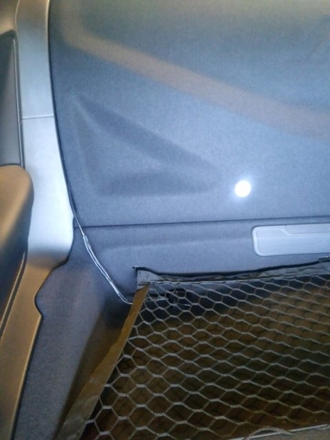

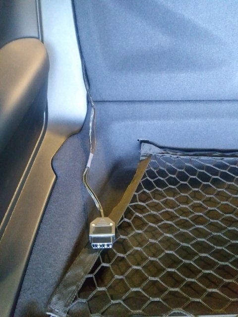

Yeah. I've got one in the trunk. I used it to get the stock file but, data logging from there is a no go. I was concerned about extending wires but....
Cake. No wires across my Lap when data logging.. Z automotive Double Bypass Cable.

that’s the way to do it! Hell I copied your design!!
