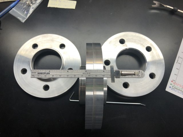

View attachment 12791 I still can’t take a hammer to my car, my 315/50-17’s will just see track duty and I doubt anyone is going to notice 12 mm of extra stick out from the spacers I made so they don’t rub the rib. Nice write up though
Nice! How big are those? 12mm? make them yourself?

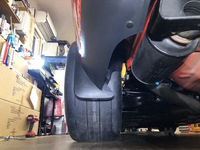

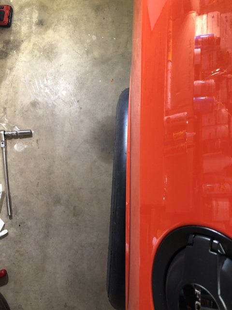

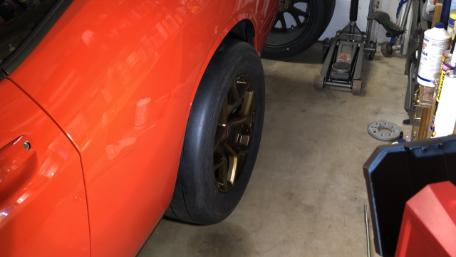

Do you have any side pictures to see how much it's poking out? I can't justify a hammer to my car as of yet either, but I'd like to run 315s too!

Started with 11 mm, they rubbed when cornering and upon being aired down to 18 psi in straight line so made another set at 14 mm. I drew the sketch, machine shop buddy made them for me. He’s making another set now for a member, $160 shipped. Could probably get him to make more but need to know quick.

Would Not exactly be pretty on the street but I don’t plan on ever running them on the street. Veteran track guy told me to just run them on the track, get them seasoned with track prep and not run them any where else, not even back and forth to the track for best performance and longest life. Going to try that this season

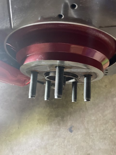

Just a heads up you might have to get longer studs. I was gonna try 8mm before the hammer & my shop said I would need longer studs especially for drag racing.
Maybe look into it for safety and so nothing goes wrong at the track.

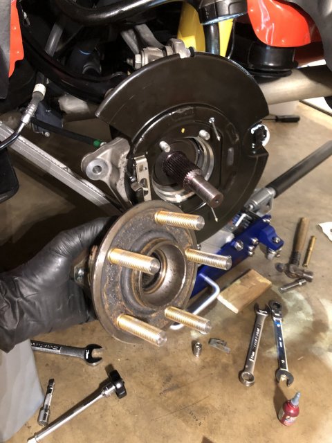

Good point, Yes, longer studs are required, I upgraded to ARP studs cut to a custom length so I could use stock rims as well with OEM looking deeper nuts or open ended nuts at the track if needed, have ARP nuts as well.

@16GoManGoHC2 how on earth did you get the e socket bolts out without removing the axles
3,792
8,969
Use a 1/4 drive E socket on wobble end extension, put the nut on the axle and push the axle in compressing the CV which gets the hub out of the way enough to get the socket on the E headed bolts. Don’t forget to tighten them first upon reassembly or you’ll be taking it back apart to tighten those same bolts. O, and dont forget to put the push nut pins that hold the E brake shoes on as theres no getting the one in after it’s all bolted back up. Don’t ask how I know both of these tips.

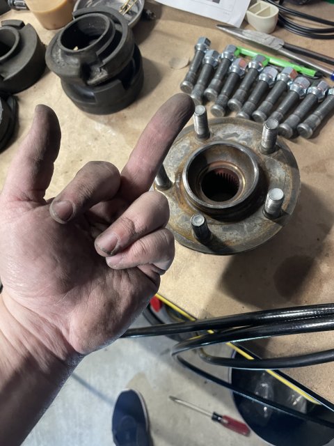

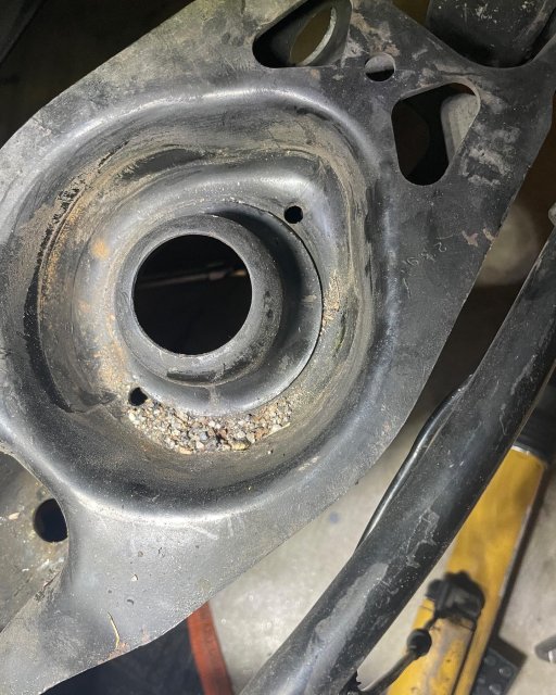

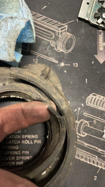

my back fucking hurts had to take the knuckle out to get to them. Only have 3/8ths and they were thick boys. One side done. Also did new isolator cups as well. Will be hitting tool store tomorrpw for 1/4ths and wobble heads

Fun fun!!!!! Yea, my family and probably neighbors too heard some new phrases coming from the garage while I was doing this too lol.

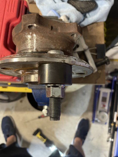

In November I went to put the winter tires on my wife's dodge journey and wouldn't you know it one of the wheel studs stripped the knurling in the hub. Yes you read that correctly
I sat there with a die grinder and ground the nut and stud till the ALUMINUM wheel came off .

4,117
10,339
Think I found the clicking issues. Also my back has never been happier.
