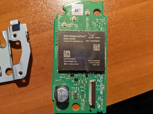

I read through the Sierra datasheet and don't see anything about an integrated antenna. I see 3 rf connections, gps and 2 cell. What documentation were you looking at? I'd like to take a gander at it as well.
The manual should be viewable on this site.
3.2 discusses the RF specification for the embedded modules.
Page 20 also mentions "...the antenna traces of the AirPrime AR7552 embedded module which located on the CCB are defined in the table below."
Welcome additional input on interpretation here. I'm inferring that there is an internal antenna (in addition to two external) for 2 main reasons:
- The manual refers to the embedded module TX/RX, as well as the antenna trace on the circuit board
- The fact that with all external antennas disconnected (plugs empty), the card maintains a strong 3-4 "bars" of service, and can actively use 4G for searching data, so that reception is coming from somewhere other than the external connectors

I deal with Sierra wireless comms constantly at work. Ironically we are doing everything possible to keep the network satisfied with sufficient signal strength. Constant drop out. The slightest marginal connection and zero data RX TX. Probably different architecture than the cars integrated cell Satellite Nav with link to PCM. Lot of things going on within that interface module.
Ironic, indeed! Any insight into where the antenna trace might be on this card? (I take no credit for the photo, it's from one of the jeep forums):
Based on the integration manual's drawings, my first guess is just above the upper right corner of the main AirPrime heat spreader.
Could also be a multi-layer card, with the antenna inside. Ugh...

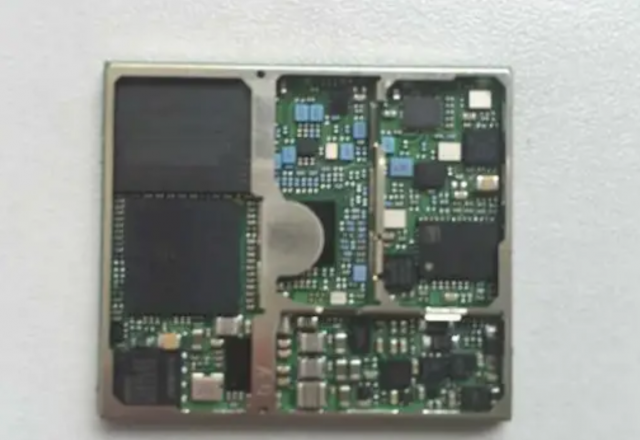

If you wanna get super detailed, here's a shot of the inside of the 7552 module with the heat spreader off, courtesy of the FCC:
