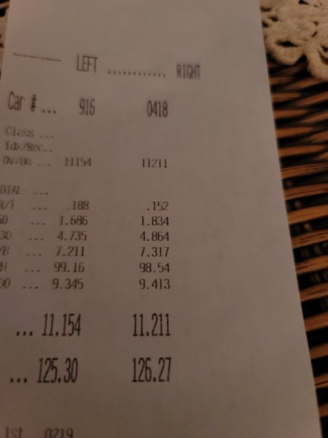

I am assuming this early in the season it is pretty much just test and tune.
If it is are there a bunch of cars on street tires? Is the track prepped?
You shouldn't have to spend a bunch of money on suspension parts on a stock car imo.
The track is at low elevation and at this time of year the air is pretty good. Not late fall good but better than August.😉
The 11.2 with the 1.62 60' has me wondering if something else is up.
What does the rest of the slip look like?
Mph gain from 1/8 to the 1/4?
In cool air you should be gaining between 25mph on the low side or 27mph like mine does.

Yeah its a test and tune. And I should have posted this already....
That's about what my Charger ran when it was stock.
Chargers are a bit slower than Challengers when stock for some reason.
