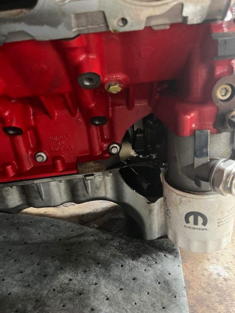

yup straps and tips melted off of number 4 plugs as well. Cylinder had some serious heat in it.
8,739
7,669
8,739
7,669
Impossible and expensive to do on these cars, but this is why racers pull and replace plugs after ever few hits
8,739
7,669
You can read the plug and see what it’s doing. Still a skeptic these just explode instantly with no warning

It's not just cyl 4 that looks like hot garbage.
More than 1 set of plugs have very noticeable damage to electrode or ground strap.
Multiple issues or failures are likely. Without sitting in front of the parts and/or also viewing a full datalog it's all pissing in the wind anyway.

So cyl 4 not 2, interesting.

What type of damage did your engine have? I missed the pictures if you posted them. I'm guessing the damage looked similar to Jon's if your engine let go while taking a leisurely cruise.
4,385
10,911
If there is a defect in the engine then we would be seeing lots of stock Redeye engines letting go, that doesn't seem to be the case. What I think is more likely is that the Redeye engine isn't happy with too much power over stock. We know that 1000 hp is too much, Dodge figured that out for us while working on the Demon 170.
This faluire does not look like mine. At one point this fall I was keeping track of stock failures. I saw 2 and 1 popped headgasket just over Facebook 100 percent stock cars. I haven’t been keeping such a close eye on the groups lately. But I do not think cylinder 4 was any of these. Typically it’s always 2

Mine was a cylinder #2 failure…..piston lodged in the block and the rod ripped the bottom out of the piston. Stock boost on E85, probably added around 60 to 70 HP…… a total of about 60 passes in the 3 years I’ve owned the car. i’m convinced with the majority of the failures being cylinder.#2 but there is some type of defect. I don’t have internal pics.
