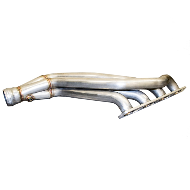

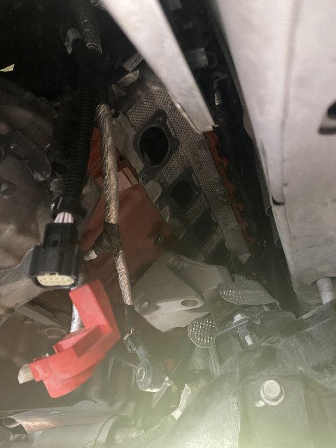

You should post pics of the headers. The pic I found shows lots of room. Only bolts on a 392 I did from the top were the front 2, all the rest were done from the bottom

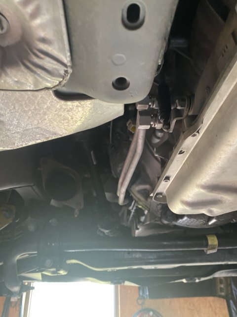

If you were close I would come over and help so I could see if there is much difference from a 392 to a Hellcat. Looking at it not much. The cooling lines on the passenger side are there but going from the bottom not sure they would be in the way.

That pic is the drivers side header. I’m not worried about that one. It’s the other one haha.
I’ll get some pics when I get to the shop

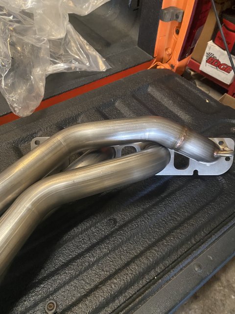

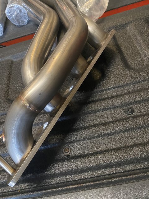

I’ve had these headers on the shelf for over a year. Since before I had the car even. Had some time and a helping hand so.......

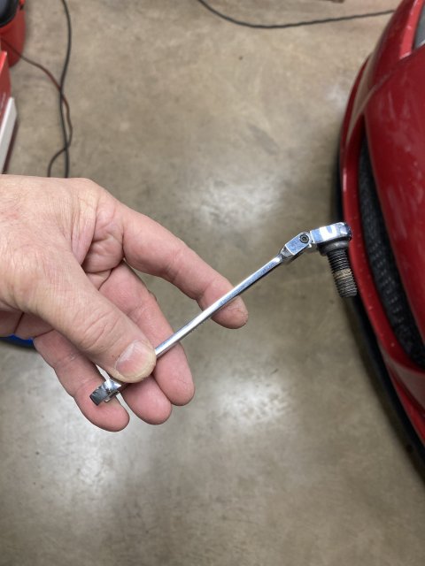

Get a flex head gear wrench, 10 mm is the ARP bolt size, I think stock is same size as well

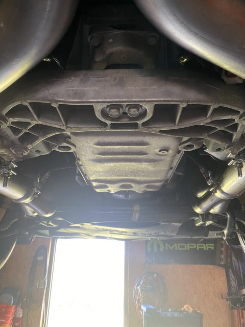

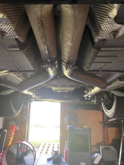

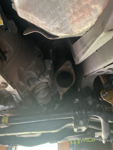

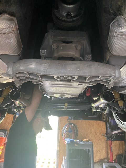

Went much smoother than expected.
dropped K member to the last few threads on the bolts.
got all manifold and header bolts from the bottom.
I’m used to stock bolts being too long and the TSP kit did not come with bolts.
I had a set of 12pt ARH bolts I found in the tool box.
the worst part was I apparently only have 1 12pt 10mm socket
I really was surprised to not only finish today, but I didn’t even stay late!

On my old '13 mustang I found dropping the k frame made the job much easier. I would unbolt it and let it swing down leaving the steering and such attached. I didn't look much at doing that to the Charger but sounds like it helped you.
