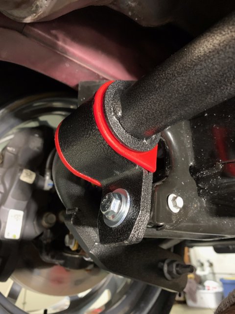

Well, it is not the links! Matter of fact the often critiqued pencil thin links don’t look like they have a problem at all. This thing has not been driven that much on the street or courses yet. I Installed different links, inspected everything again and I cannot see anything wrong. It has this what seems like getting louder and more easy to reproduce POP, just about under my feet, or right down where the sway bar action is. I am going to check everything again, and probably loosen and retighten the sway bar bushings and mounts again. Then I will need to turn it over to the boys at the dealer. They have some good technicians and they can take that damn entire front cradle loose for all I care. But for $92k I expect it to stand up better. Now these Redeye’s show their program for drag racing is potentially flawed and if you want to try lefts and rights they fail also!
Or, what if BMR has a hollow sway bar they sold me that is making a strange noise when flexed?? It only makes the noise when turning aggressively.
Not to keep getting off topic, sorry OP but in my experiences when dealing with aftermarket replacement/perf parts always look there first. Good luck with finding and diagnosis.
I have found that when you hear a noise, if you are sharp and really listen, it usually ends up being something really close to what you are thinking. I would look really closely with a strong light at the area under your feet and in the wheel well and trans tunnel for something (a tell tale) contacting the floorpan etc. Keep in mind sometimes things could be minor and sound terrible in the car. Like when a rear tire contacts those plastic wheel tubs. You can really hear that inside the car surprisingly well.

Thanks gentlemen. @coolblue good advice. @DRAGRCR also correct. I was thinking like a combo of your suggestions today when I put the gloves on. Ron the noise was there, I also practice what you say, damn it, the noise is coming from here. Took the aftermarket sway bar off, cleaned the large bushing and reapplied grease on that unit. Carefully reinstalled everything. The pop is gone! Seems the bushings may have been squeezing down, the grease probably got hot when the supercharger bushing got smoked in May, so the relatively little small noise from that bushing/steel slip-stick really gets amplified in the car.
So glad you guys like the video, that is really turning a RE loose. I’ll have much better audio from BIR next Monday along with a speed overlay and even faster speeds down that straight. The RE should see 165-170 mph in less than every two minutes if everything is right. So we can get back to the business of the hiccup now,
