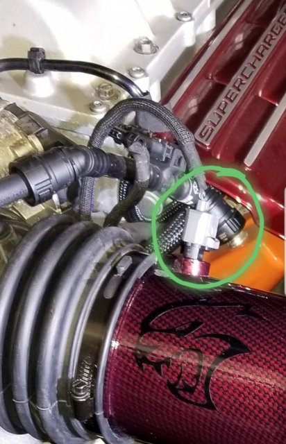

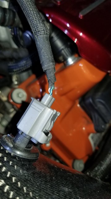

I'm not sure . On my performance pages I have a guage called " intake air temperature " and to be honest I'm not sure where it gets its data from . But I can tell you this if the ambient temp is 60F and my low speed IAT reading is 90F and I flash the throttle it will drop to about 80F instantly and either drop more if the throttle is open still or go back up if the throttle is closed . I have not done any long WOT pulls yet so I don't have any data on WOT yet .
Exactly. I too want to know where this sensor is being read on the air inlet tube.. 20200512_161223.jpg
11,025
Exactly. I too want to know where this sensor is being read on the air inlet tube.. View attachment 17352
I wonder if it's used in the calculations. Like it takes reads from ambient, pre throttle body IAT , MAT and uses them to calculate something?
