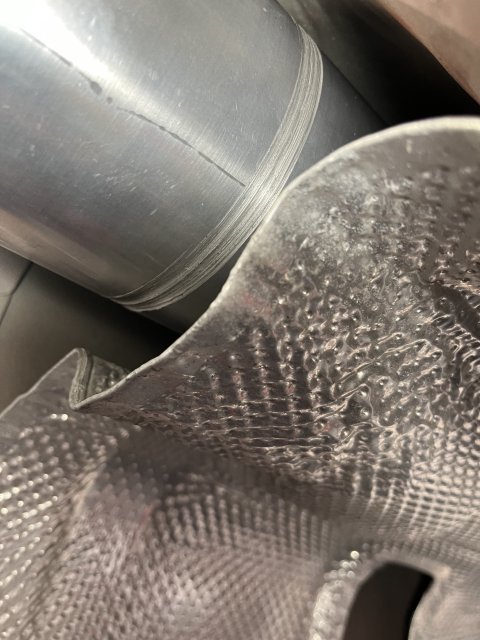

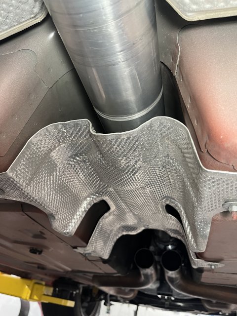

Thread Starter #116
A couple updates, between bad weather, a case of pneumonia and other commitments I still haven’t made it to the track.
I didn’t like the noise the differential was making so I pulled it out again and had it set up properly, we found the backlash was definitely out of spec and we now have a very nice pattern and proper setup.
I also decided I didn’t like the groove in the aluminum driveshaft and rather than trust it not to fail I ordered a carbon fibre driveshaft which should be here early next week.

Where was the groove at in the driveshaft?
You probably posted it but.......let me know anyway.
The groove was right at the back of the rear heat shield. It’s hard to measure exactly but it’s about .015” deep I would guess.
