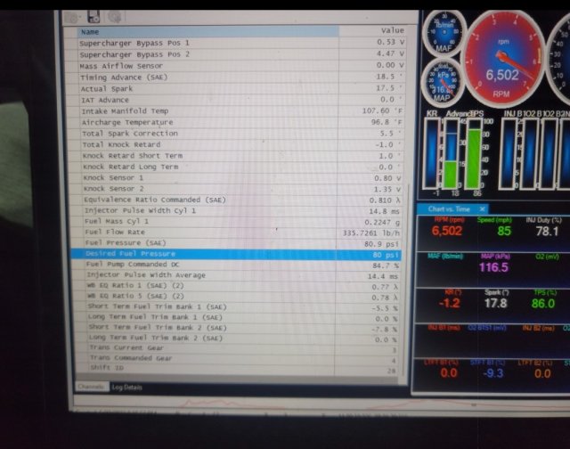

Seems there may be multiple things going on. Forgot to attach the log file to Jons email but i did snap this pic. This wasnt an issue before changing the BPV. Bare in mind i have 1200cc injectors and hhp dual pump kit

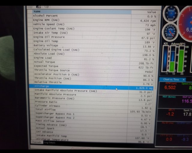

ok heres what we know.
I verified both fuel pumps are working simply by unplugging one, car fires up and runs. switch to unplugging the other, car fires up and runes.
When we first tuned the car we didnt have any fuel issues as you can see in the attached. desired psi and actual psi were matching pretty good. if you refer to previous post, now im dropping down to 65psi in some spots. We think because the whole time I had a leaky BPV, we got that fixed and now were pushing more air which is causing the fuel pumps to be over worked.
what I cant seem to wrap my head around is this:
I had 80 psi and commanded 80 psi
now I have 65 at spots and commanded 80
I had 1850 air charge now im around 16-1700
My gauge was showing 18-19 psi of boost
Now im only showing 15-16
But when you look at a log under boost, its showing me getting 18+
so I then figure out how thats calculated. (vcm scanner say MAP-Barometric)
well my MAP - Barometric is 22.5 so now idea how were getting 18?
Additionally it still doesnt show on the gauge (max is 15-16)
I verified with Jon today that I am running all 4 3 bar MAP sensors
this all stems from the much more knowledgeable members stating my time slips reporting a slow time with the provided mods i have therefore I must be down on power. So even if its just a glitch and my dash is reading right but i a making 18-20lbs, than why so slow? lol.
Sorry for the long post, Im sure everyone is fed up with me by now. Im just trying to fix this thing and learn along the way.
PS. Bare in mind the attached log pics are from an earlier tune and log (months ago) the knock has been corrected long since then

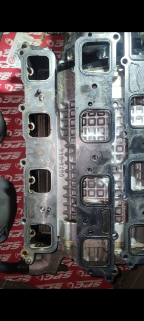

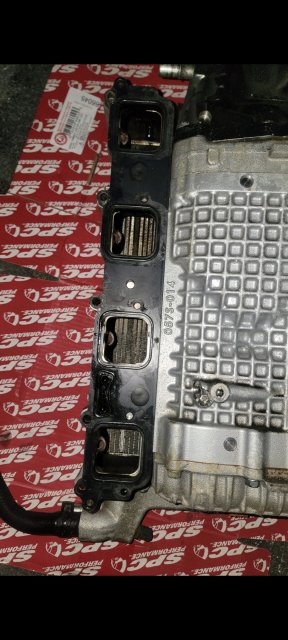

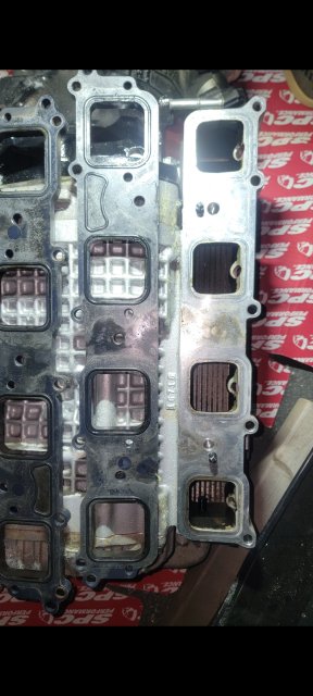

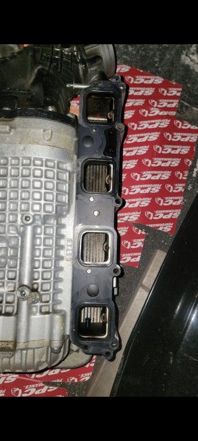

Went to dyno today. Only made 832whp. Decided to pull blower and inspect gaskets. I have the blower spacers. I see some oil residue(blowby) and im running a catch can. Clearly im down on power. Jow do these gaskets look to you all?
