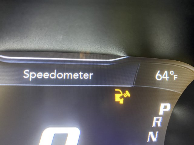

Ever since I got this light on my dash when I put the pedal to the metal it makes the engine cough and die. It does not stall. Are these two items related? Now that I’m thinking of it I have 5 gallon e85 canisters in my garage. I filled her up a few days ago where the e85 was coming out of the neck. By the neck is the evap system. I bet I filled the evap system with e85 and not vapors. So when I put the pedal to the metal it is probably flooding the engine?

Holy Shit!
I didn't even know we HAD a gas cap light...
Now I'm going to go key through my ignition sequence and see if that isn't something new....
Oops, 'just saw that you're on a MY16 as well...

Ok, so not a "light" but a "graphic", and it doesn't show up on the Start sequence, so I guess I don't feel quite as stupid... (but still mostly...)

It is ok. I never knew I had it either. But Tony the service manager at Chrysler jeep thinks that is what I did. He states it happens on the grand Cherokee all the time when people keep clicking the fuel handle to get every drop they can put in their tank. I think it is not the fuel cap. But what I just stated. I will know Tuesday.

why did you fill til it came out that neck?

Is that a rhetorical question? We know the answer. I should not of.

I thought maybe something was being tried as an experiment or the jug slipped or something. For what its worth, I think you're right, the vapor evacuation system is probably throwing a flag and causing havoc.
