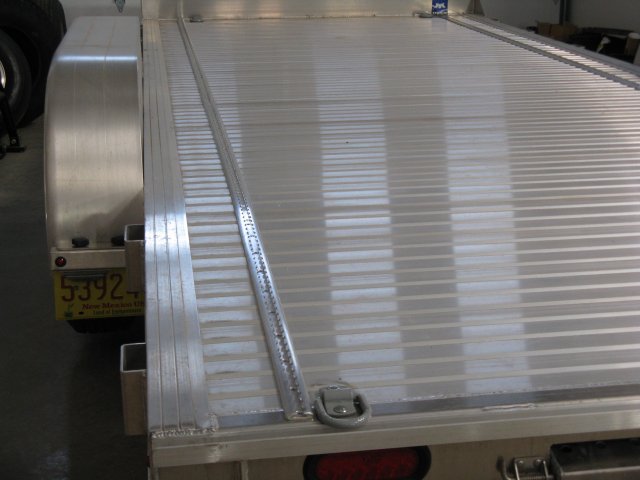

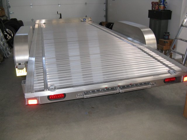

I put L-track on mine so I could use wheel nets and/or wheel straps. I'm one of those that refuse to tie to unsprung weight.

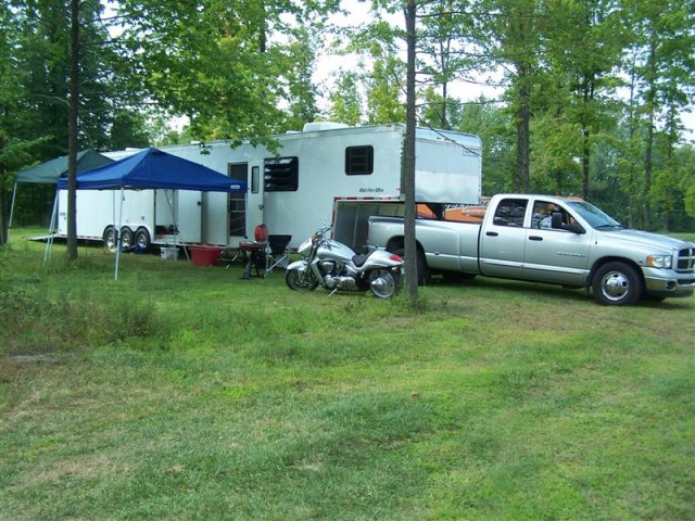

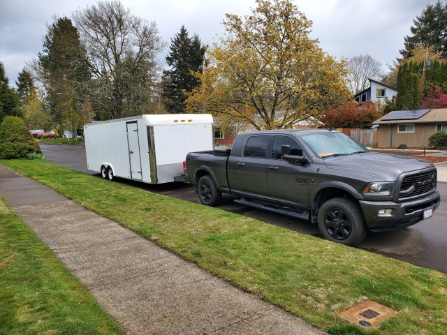

This is my 6th trailer. This has 2-7500lb axles. 14 years old, and the spare has never seen the ground. It's been everywhere, and on it's 2nd set of tires... due to age-cracking sidewalls.
This was ungainly, but served it's purpose when I ran Nostalgia Pro-Stock.

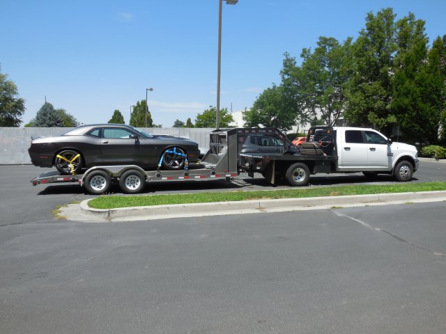

I've transported all kinds of vehicles on my 18-foot trailer, but recently decided to look into getting a 20-footer.
Well, they don't seem to make this kind anymore, so I'll either add a foot or two to this one, or simply leave well enough alone. DSCN2112.JPG DSCN2124.JPG
30,619
134,775
Well, they don't seem to make this kind anymore, so I'll either add a foot or two to this one, or simply leave well enough alone. View attachment 126241 View attachment 126242
I like the trailer to take the hit if possible.
5,566
10,673
Yeah, that's partially what made my think about a longer one. But if you look at the Challenger on the trailer you'll see that it could've been moved forward by over a foot.
Of course, my unfair advantage is that by driving fast, the odds of getting rear ended are minimized.
Anyway, at 16.5 feet a Challenger fits fine on an 18-foot trailer. Even a gooseneck where there's a "wall" in the front.
30,619
134,775
You can see in the picture that I posted with the Challenger that it has plenty of room on both ends. Enough for additional tires and gear.

A 10K rated trailer will just beat up your 'Cat, unless it's air ride. 5,200 is ideal I think, but with an aluminum trailer 3,500 will work, just keep an eye on the bearings.
View attachment 126185 View attachment 126186
Funny you should say that. I looked at 2 other mfr's of alum trailers and they both warned me away from their 7k recommending the 10k, maybe their spec was optimistic? I contacted Rance, they the 4500# HC should be fine. They further stated a trailer rated for a load higher than the actual load will cause a more harsh ride for the Cat. Made sense to me, but I'm only an engineer.
