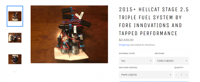

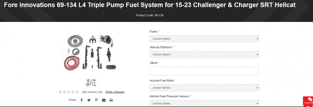

Looking to upgrade my fuel system from my current setup which is just the HHP Racing plug and play dual walbro 525LPH pumps to one of these, but I'm not sure which one to go with and the differences between them exactly? Are these essentially the same thing? Seems like the Tapped Performance one is more user friendly/easier to install? For the high horsepower guys what are you running or what would you recommend? L4 System.PNG tapped fuel system.PNG

I would stick with FORE 3x 525's with (3) boost-a-pumps. U did say HIGH HP..... Some say the (3) boost-a-pumps is too much. I had another tuner tell me that wasnt enough but so far so good.
What blower are u running? The 3.8 Whipple requires GOBS of fuel.
