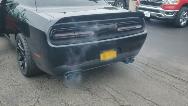

Question for those that had this V86 recall done -> When you picked up from Dodge was the car smoking very bad from the exhaust/rear of engine? Smelled like burning on the 15 mile drive home.
When I got back the exhaust wasn't smoking as much but still coming from engine bay. Terrible smell. White smoke.
Pic:

Pretty sure that is the new cats burning in (the smell). Mine did smell for a bit, maybe just the first few days of driving. Don't know if mine smoked, never noticed.

Mine didn't smoke, but did smell for a little bit

I had mine done a few weeks ago. There was a smell for the first few days which they warned me about. The one thing I did notice was they had left the large paper part number ID labels on them. The exhaust tips were also uneven, so while I had it on the lift I removed the labels to keep them from burning up. Perhaps its the labels burning you’re smelling?

Also, smelled gross, for like 3 days, after the recall. After that, all is good.

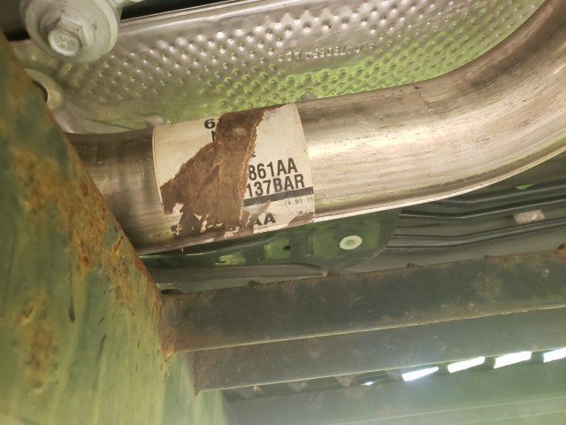

While loading the car onto a flat bed today took a look underneath.
Burning smell/smoke was from stickers left on i believe. The ones on the downpipes burnt off, some ash residue left. Two still partially on the mid section.
Makes me feel a bit better, off to get the build finished.

I thought it had to be something shipping / inventory related that was not removed.... dipsticks
