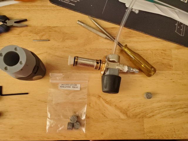

Changing out foam agitator now...will report back once I confirm it fixed it.
What is that, some type of stone like those aquarium air stones?
Looks like maybe some routine CLR or de-scaler needed to dissolve hard water deposits, if your water has a lot dissolved minerals in it?
It is a mesh filter. Could be when I rinse non DI water to clean it before putting away?

Washed a car just now...Foam Cannon back to running like new.
Good observation about the rinse. I'll have to use my DI when rinsing the unit.
Glad to hear it's up and running again.

Thread Starter #37
Only thing I can think of...fill a little DI in a bucket for rinse spray with pressure washer? Or, those mesh filters just get plugged overtime? Had this foam cannon over a year or so and do use a lot so maybe just a wear item? Hope this can help someone diagnose.
