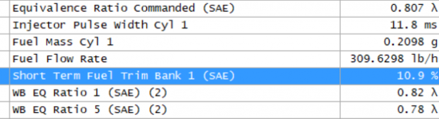

I saw some higher spots where stft where having to add fuel in this log. One spot 15%. Luckily, It looks like it is happening on decel. On acceleration it starts a little lean and turns to the rich side. For the cruising log.
As speedy said I noticed the Lean spots in your STFTs but weren't anything to crazy. It does look like your stft are adding fuel most the way through the pull.
Most people would like to see it the other way. As speedy said it isn't bad enough to worry about. Here is a snip of what we are looking at. You can see STFT are positive 10% meaning it is having to add fuel. If it were -10% it is taking fuel away meaning rich which is safer.
As you can see your commanded and WB EQ ratio are close enough where it really isn't causing an issue. This is from your WOT pull. You could mention something about lean and stft adding fuel and you would rather see them a bit rich and take fuel away if you are still in the tuning process. If tune is complete and signed off I wouldn't worry to much about it.
