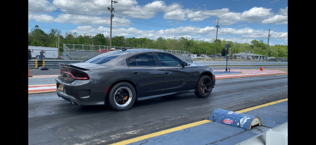

Headed to Island yesterday with a few guys. Beautiful day to be at the track. Prep wasn't bad, temps were hovering low to mid 70's, humidity around 50%, and DA at 2000. First time drag racing this boat.
18 Charger HC with LMI, upper, injectors, tuned by Barth, diff brace, D5s on ET Rs. I was full weight and on pump 93. I got faster as the day went on. 3 runs only before track closed. 10.65@131.32 (1.60 60ft) was the best pass. Got bad shake on the top end after the tires started to spin on the rim. Next up, trip to Atco with some negative DA and weight reduction.

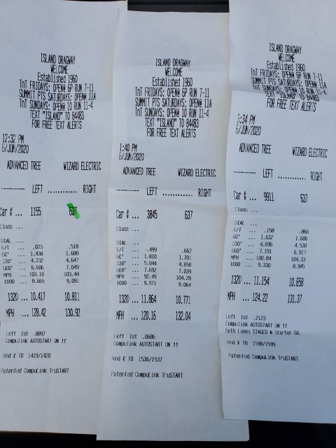

All 3 passes. I'm car 637.

Nice , #3 1.60 60' is good & when you were at 1200 / 1300 rpm , you can try a little higher rpm next time & might do better. And depending on how much time between passes for cool off ? … keep eye on tire psi & adjust as needed to be consistent with psi , the faster or not you make passes the psi will be different.

Also work on RT , shallow stage & leave on the 3rd yellow on tree , that will help RT.

I wasnt worried about R/T since it was my first runs in the boat. Ill work on it once I am consistent.
I actually have about 500 passes under my belt dating back to 2000 lol.
