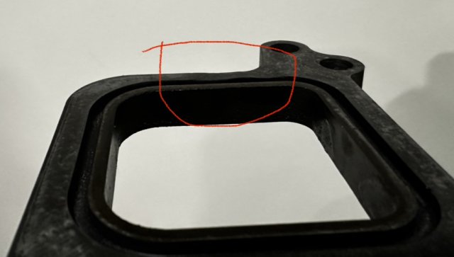

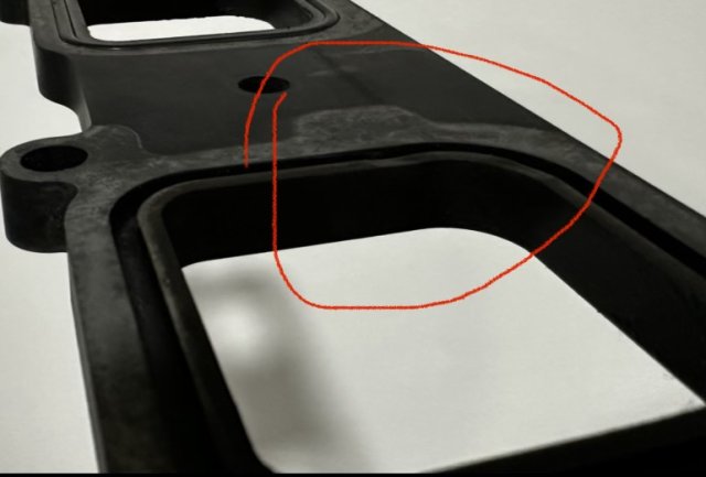

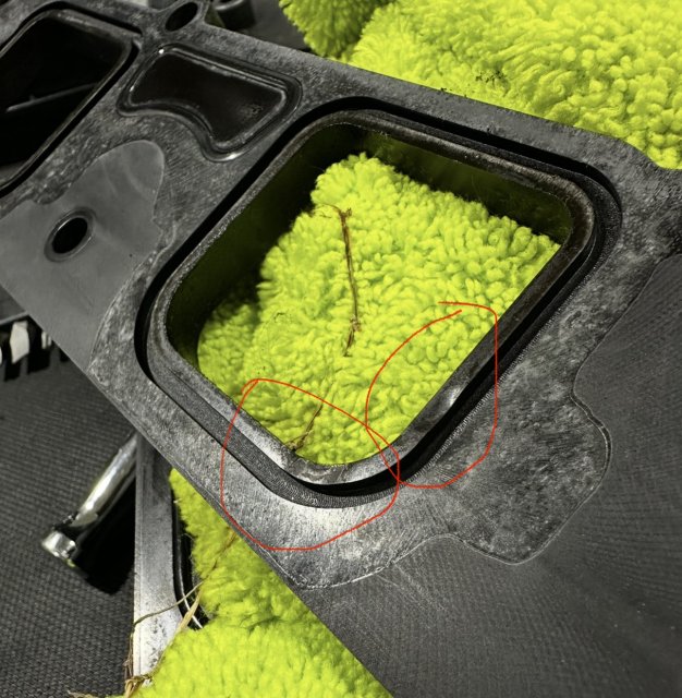

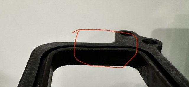

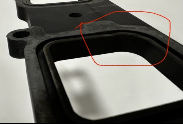

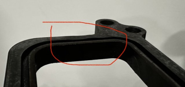

Welp worse case scenario for that o ring. It warped the spacer. What are your thoughts on this @16GoManGoHC2 ? Think new o rings will seal it up?

The o rings won't even stay in up top they all popped out as soon as I took it off the supercharger. These o rings do not hold up to the heat

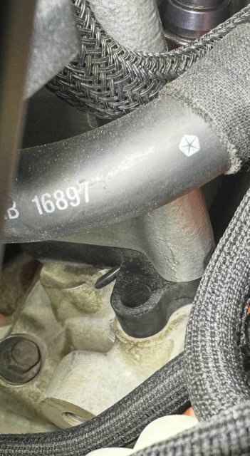

How did you discover this in the first place?

Are these the new o-rings? The Viton/FKM ? or the original NBRs?
U
8,408
7,327
Original.
While installing the 2 step, noticed 1 little piece of o ring sticking out of the front on bank 1. Not really noticeable in tune but those 2 cylinders most likely would have been getting more air.

I'd just replace them with FKM and send it. Bet it will still seal just fine--just watch it to be sure.

Less than 100 miles driven like this and haven't gotten on it. So lucky there, bad because where the o rings were rolled over it left an indent in the spacers

That front one isn't concerning. This one that I would have NEVER seen is. So 2 issues. This piece made it into the engine and dented the intake/pressure side

Same bank, cylinder 5

you could try heat cycling it in the oven + freezer a few times and see if the deformation goes away.

They seal on the o rings so they "should" be fine, but lot of work to put back together and have to take back apart for a maybe. They're also not flat anymore, very slightly like bananas

The slight banana warp wouldn't bother me, as long as the thickness is really consistent over the length of them, measured with either good calipers or micrometers

It is, it's just a slight indent where the o rings rolled over and it has camped down, on the head side

Not sure if I want to send 20lbs of boost through it through

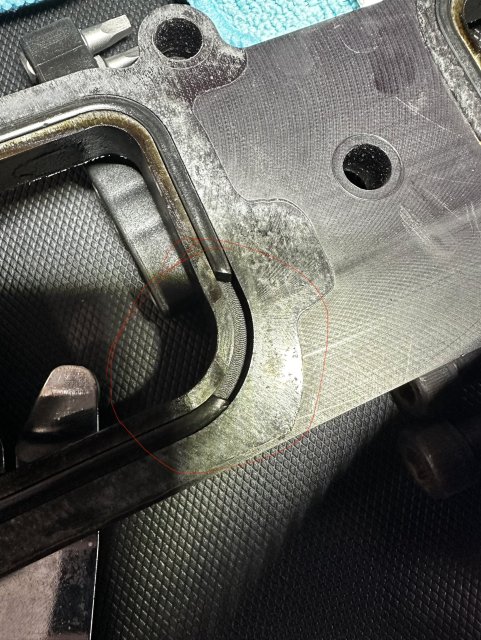

Difficult to get pictures - cylinders 1 and 5
