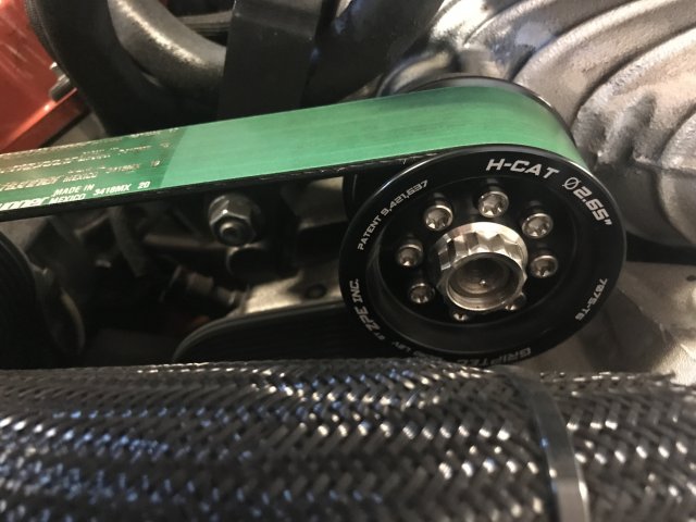

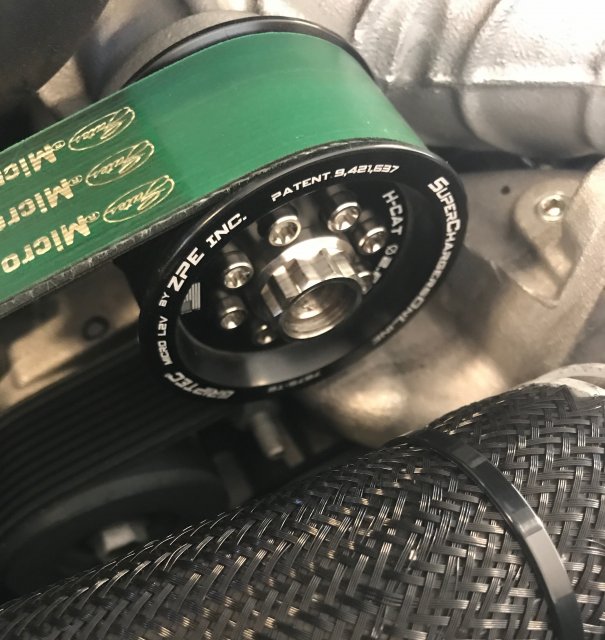

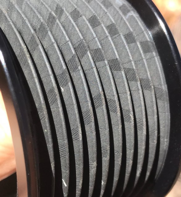

I was running 2.65 Griptec on my 900 whp Challenger and wondered why anybody would use anything else. Every Metco pulleyed car I ever rode in had belt squeak. Very annoying. I was running that 2.65 with a +10 ATI and never had any slip, dust or noise. In other words... it didn’t slip. And that was just using the stock tensioner without a additional idler to increase belt wrap. The surface may wear down over time but I didn’t experience that due to not putting a lot of miles on the car. As far as the quality of the hub and pulley combination.... there is nothing better. 5A442F77-81BA-485F-9CC0-29E75E2F92AB.jpeg EB14C23D-38D8-4CC5-B84B-9415534E21AF.jpeg B6E57FD5-1419-4922-91BD-BE85CEA79FAC.jpeg

I was running 2.65 Griptec on my 900 whp Challenger and wondered why anybody would use anything else. Every Metco pulleyed car I ever rode in had belt squeak. Very annoying. I was running that 2.65 with a +10 ATI and never had any slip, dust or noise. In other words... it didn’t slip. And that was just using the stock tensioner without a additional idler to increase belt wrap. The surface may wear down over time but I didn’t experience that due to not putting a lot of miles on the car. As far as the quality of the hub and pulley combination.... there is nothing better. View attachment 7148 View attachment 7149 View attachment 7150
Do you run this setup with E85?
