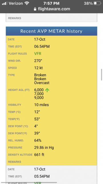

My DA playing around the other night:

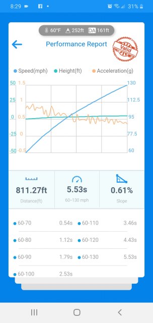

Here is my dragy capture for the run. It seems my acceleration drops off quicker than yours...
High iats. Computer pulling timing to save itself.

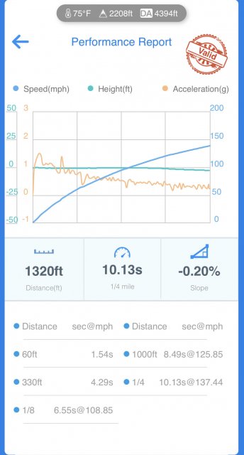

I found some great track prep a couple weeks back and the car was able to launch under full power @ 2000 rpm in first gear. The feeling of hooking up that hard is an adrenaline rush that is going to be hard to beat!
I am still scratching my head at the timeslip though. The DA was terrible (4500+) and I am still full weight (plus my fat ass) but I feel like that 9 sec slip should be easily possible at this level. I am beginning to wonder if the trans has issues as I can't find any other reason for the times.

Like everybody else has said, 4500 DA is the only thing holding you back from mid 9's compared to sea level & 0 or negative DA.
Be careful though going from high altitude tune to sea level without getting it tuned for low altitude, bad things can happen.
