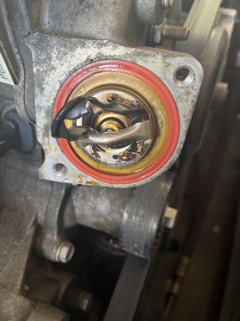

So I changed my T-stat over the weekend… anyone see this before? I’ve seen it while racing but never in a road auto…

What is it?

Thermostat with the rubber ring melted and stuck… so basically the T-stat was open all the time. I removed it and it was stamped 203 degrees. I removed the rubber and there are 6 holes drilled into the face…

Yes, seen it before. Usually after an engine had been overheated.

I have seen it on the race cars I was part of the crew with… I don’t think stock T-stats came that way
Yes with the rubber gasket from the T-stat in the face to stick it open

Haven't seen that particular failure, but those rubber gaskets are notorious for breaking down, crumbling then polluting the cooling system with little black chunks. Been an issue since 2005.
Chit design.
