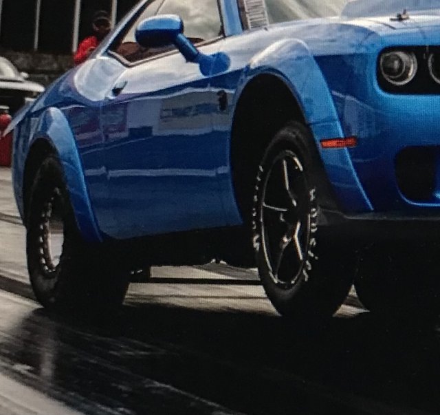

I cannot find them on the MT website. So if you are sticking with MT it looks like there are two choices. There is a ton of weight on the front end of our cars. If a total race car without the added weight of the AC and maybe an aluminum block I would go with the lighter tire. But otherwise I opt for the safer heavier front runner.
3,630
11,710
#60
Sportsman is the best choice if the car is street driven. Period. The ET-R is a good choice if mostly a track car with cautious street use. The light weight M/T that I’m using is a 17”. That tire is not available in a 18” and is race only. If you want a lighter 18” tire for racing then the Hoosiers are the best choice. Many fast Hellcats using those without issues. 079D9076-BE8E-4520-B9F0-26B6AC767320.jpeg
