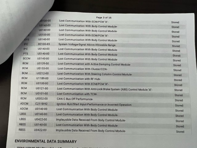

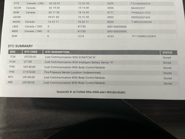

Got it into our service department yesterday hoping the battery would test bad and be causing the issues but the battery is fine. It spit out a TON of codes though, a lot relating to the BCM. codes1.jpg codes2.jpg

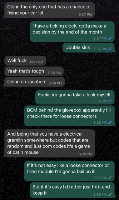

I am hoping it's just a bad BCM or loose electrical connectors at the BCM. I have the option to completely walk away from this car with no cost out of my pocket, and I am starting to consider that if it's not a simple fix. For some reason, electrical issues really get to me as I've seen cars with stuff like this not fully ever get resolved. I do still have my 2015 Hellcat as well so it's not like I would be without a Challenger. Investment-wise, I think having a last year Redeye would pay off in the long run, and I do love the car aside from these issues so I'm a bit torn.

Yeah it’s unique to this vehicle only. Seems like a lot of modules don’t want to talk to the BCM or vice versa with some PCM and TCM communication issues thrown in for good measure.

Rf hub/bcm needs to be replaced

That's almost every module on the canbus. I wonder if you have a bad canbus connector.
That’s my thoughts too. Especially with it displaying no bus on the cluster. Even more fun because it’s random.
