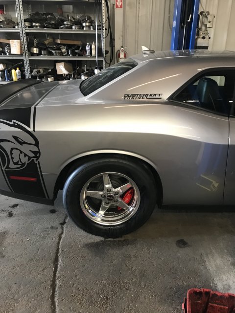

64017402-91B8-4E17-970D-65A75B4D5AEF.jpeg 64017402-91B8-4E17-970D-65A75B4D5AEF.jpeg If you guys want to go faster add this sticker

#76
that DUSTEROFF sticker looks good on the silver
