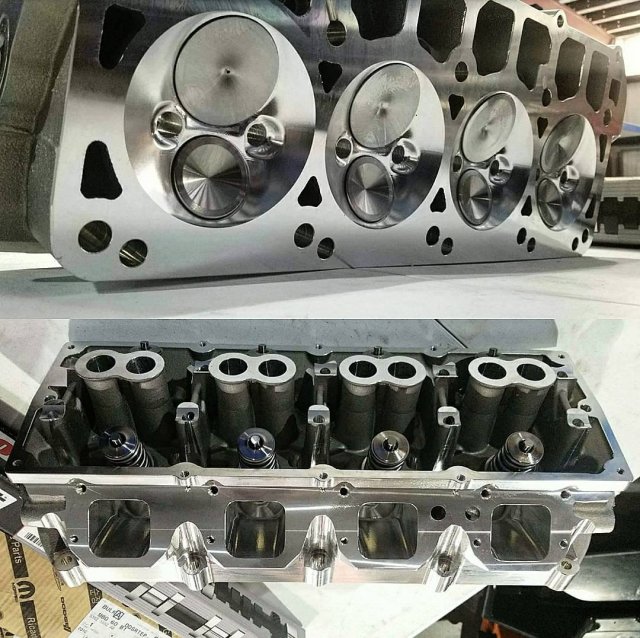

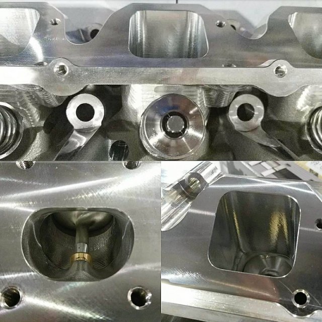

ZHC did you upgrade your heads? If so who did the heads for you?
Yes I upgraded with Thitek Bear Gen 3 Hemi heads. Unfortunately, I don’t have a before and after of how they compare versus stock or stock ported heads on this setup. They sure are shiney though.

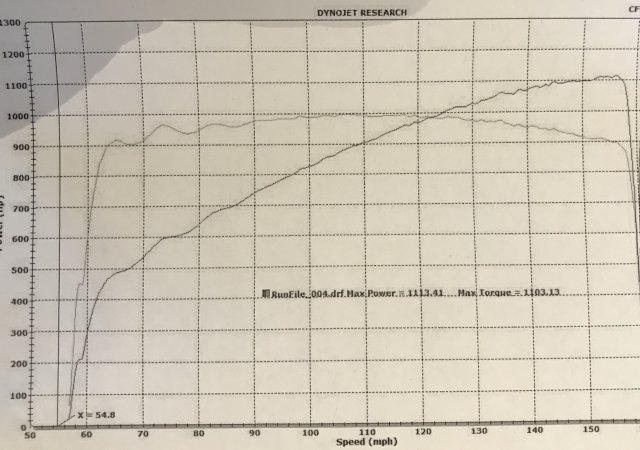

I agree. And if Z doesn’t mind..... I’ve seen the same thing with my Whipple. They have gotten some bad press from a few who for whatever reason don’t like them. My engine is very close to ZHC’s as far as the build goes. It produces its power in such a smooth/liner manor it is noticeable compared to a pulleyed 2.4. It actually drives better on the street. Here’s my dyno graph. It is not corrected. Temps were near 100 degrees with a da of close to 3000ft. This was the “street” tune with max 17 degrees timing on e85. I don’t have a copy of the “race” tune using Ignite 114, but it picked up 40whp over this. If I can get mine to the track anywhere near what ZHC is doing, I’ll be beside myself!! 2ABE8D6A-1F7F-40F7-992A-EFD53476F617.jpeg

It may be a surprise to some folks, but I never had a chance to dyno the new build before I ran the 8.9's last week. After making several 8 second passes, I decided to change that fact and see how much power she's making.
The 8.90 tune as-is made an SAE corrected 1137 WHP and 1015 torque. After a couple tweaks, I ended the day with 1155 WHP and 1029 torque.
Dyno Vid:
Here are my dyno results comparing power made on my previous stock motor setup with a 2.50 + lower versus the built 427 Whipple I'm running now. View attachment 4518
